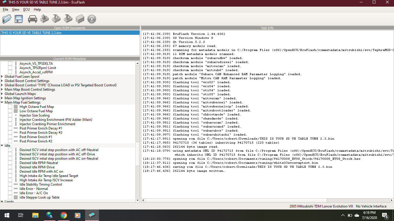

my 94172715 rom doesnt have those particular tables defined as far as I can tell but I did find that I had way too much timing at idle and that maf scaling adjustments are making a difference. Hard to tell though on constant restarting.

your rom is a derivative of 94170015, the addresses should be the same as that rom. You can verify by putting in the XML for that ROM ID into your XML and checking the values that are displayed in your ROM.

Thanks a lot biggie. I'm having pretty good luck with oddly enough maf scaling. And I know I've seen those defined if this doesn't work I'll insert in the XML

AWE YEAH. Dropped those XML tables into my meta. Bam. Control. No more baby sitting or stalling on cold starts. Thanks again biggie
