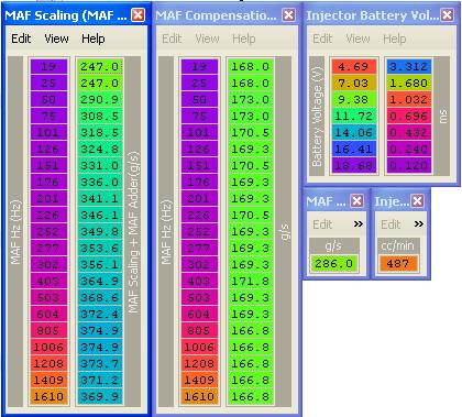

stock E3 MAF, stock turbo, stock cams and stock 510cc injectors & walbro
here are the scalings (dunno if they are correct)
as about trims, they're frozen you can check my recent thrad ))) https://www.evolutionm.net/forums/ec...-changing.html

eh can you change your MAF COMPENSATION Data Value Scaling (top one) to uint8 or percent128 and repost a picture?

here it is, changed to unit 8

try this as a starting point.
lol i see you went through this already heh. deja vu
Attached Thumbnails how to: full time open loop ?-try-.png

make sure to adjust the 15-50 hz values ON THE MAF SCALING to get your idle afr's in check.
you may need to pull back a decent amount on those areas as I had to for my 2g MAF.
if your adjustments aren't doing too much, bring them back up and pull incrementally from the MAF Compensation and then go back and make fine tuning-adjustments on the MAF Scaling.
First get the thing to idle stoich. Plug in/turn your O2 sensor back on too and log your idle stft's to keep them at least -4 to +4 maybe even 5's.
