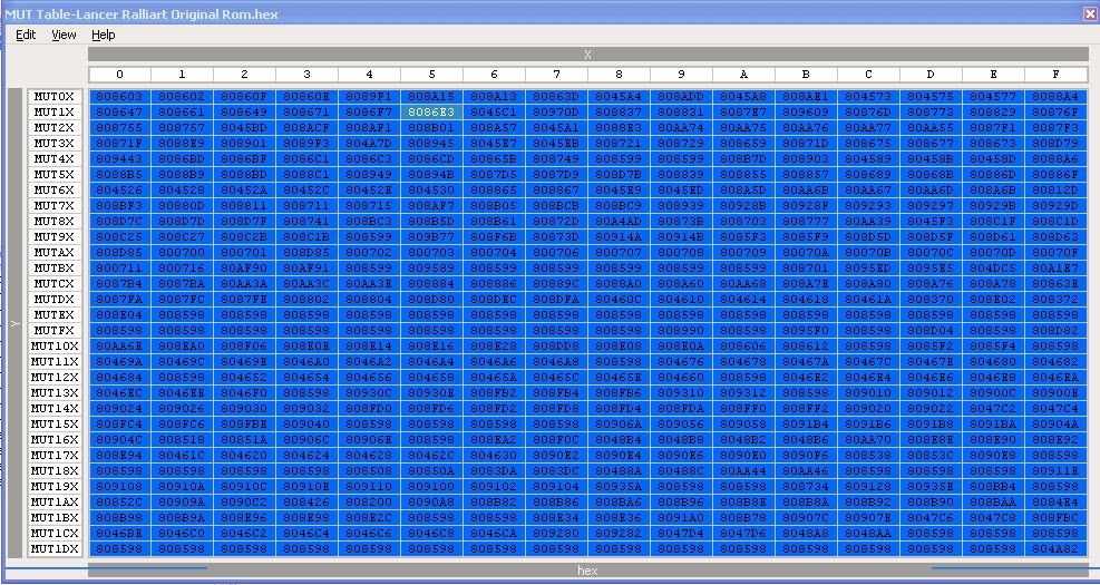

I have a problem with my 2009 RA EU (53610016), and the Boost is abnormal in Logging.

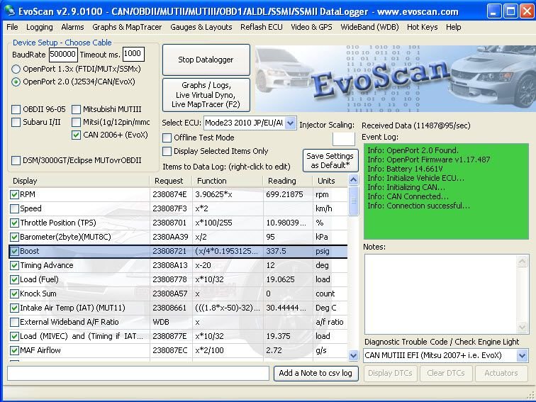

I take the adress from MUT38 (808721) and edit in Evoscan, but it dont work.
Can anyone help me?
x/4*0.190761498-[2byteBaro]
2byteBaro is also not right 80AA39 --> x*0.071763464
Whats wrong?
Thanks
Old Mar 18, 2021 | 03:59 PM
crimson red's Avatar
Joined: Aug 2009
Posts: 284
Likes: 21
From: Hokkaido, Japan
boost address : 23808722, formula:eval=x*0.0482435-[Baro], metric eval=x*0.3326271-[Baro], responsebyte=2
baro address : 2380aa39, formula: eval=x*0.07251887, metric eval=x/2, responsebyte=1
