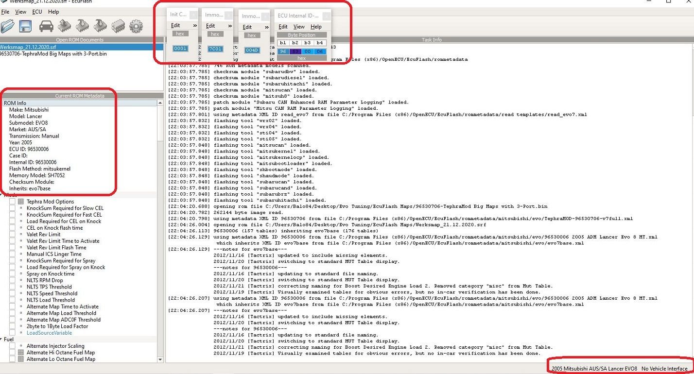

I checked now the whole OEM MAP (how can start the engine) and compare it with the TEPHRA MAP (how doesn't start the engine). With the ECUFlash function (compare ECU)
There are some difference between the two maps. But where i can find the difference marked here in red color. Maybe there will be the problem

The hashes don't really tell you anything. They would be different just from the edits that tephra makes to the oem code. You will need to spot check tables.
