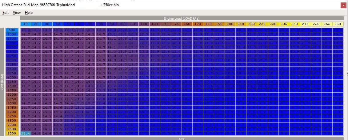

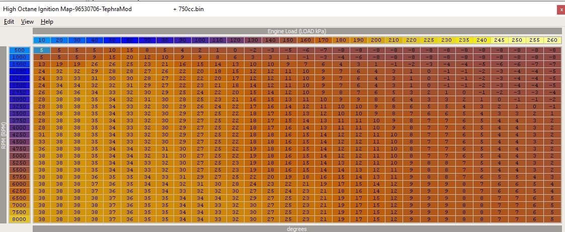

Hello Guys

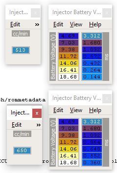

I changed my OEM Inejctors (560cc) to a new Set of FIC 750cc Injectors. Now i'm working on the new Maps.
1. i changed the Scaling and Latency of the Injectors
2. Here are the current Timing an Fuel Map (with OEM Injectors). Is there so base changement i have to do befor i start for the first drive? For Example lower the Fuel Map or something other.
