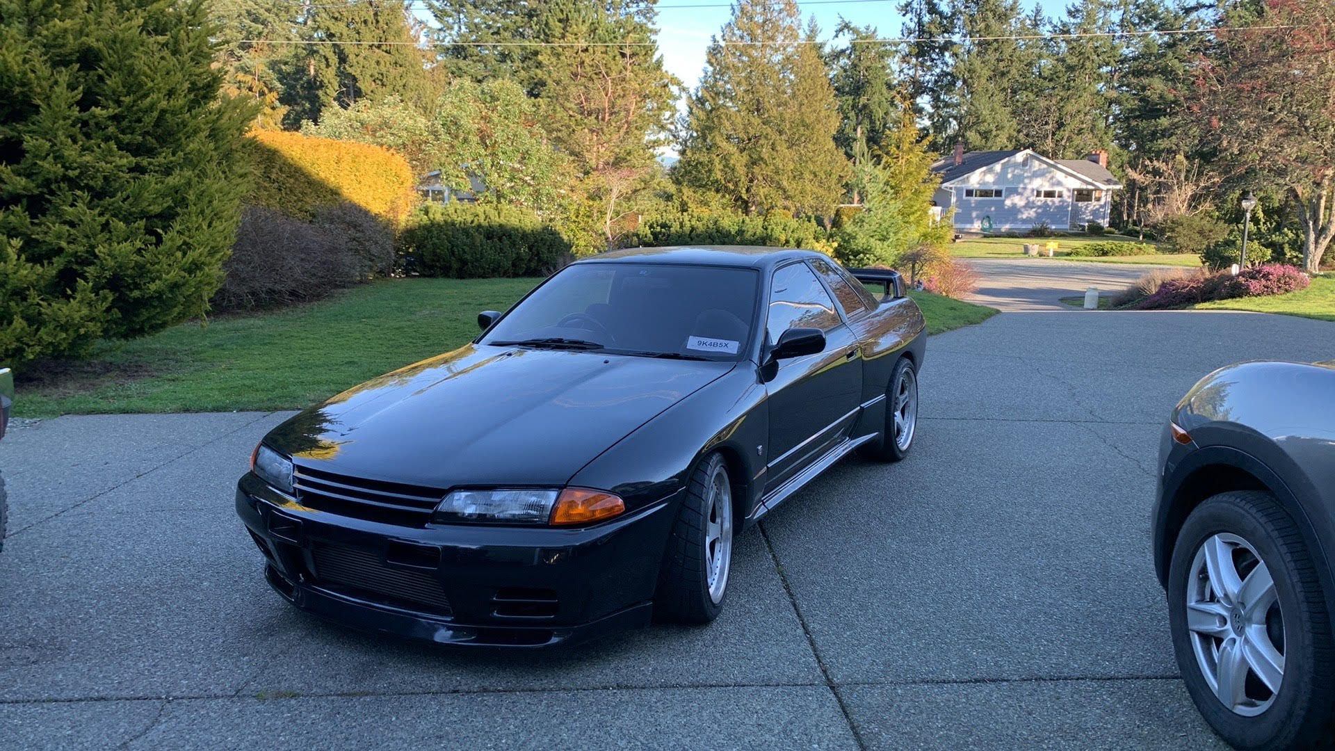

Evo 8/9 with 3 plug ECU are the same, 4 Plug won't Plug & Play.
Personally would reccomend a stand-alone Link ECU. We run one in our shop GTR running 500-600HP, hasn't skipped a beat.
Also have a shop Evo V, Not finished yet though
