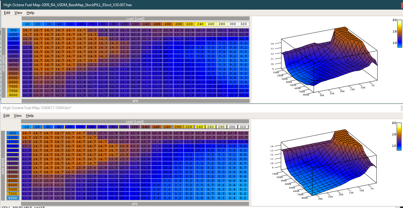

I'm brand noob to all this ecuflash/evoscan/tactrix stuff, i just pulled the fw from a 2009 sportback ralliart with ecuflash, looking at the fw file with a hex editor i think it is 53600017. Now if i open it with ecuflash, there's no xml files available for it so I used closest one i could find from 53600010.
When I look at fuel map in ecuflash it look like some values in both rpm and load axis are corrupt
GST MOD on top , Stock as pulled from car on bottom
GST-MOD on top, I edited my stock rpm and load values to match
What do you guys think? Am I using the wrong xml file or did I miss a step or something?

53600017 appears to be a new stock ROM that Mitsubishi re-flashed due to an SST transmission recall. See this thread for reference.
It looks like they moved several tables, including the key 1D tables for load and RPM around in the ROM, so your xml file for 53600010 is not going to work.
You will either; need to work with someone who is familiar with the 2009 Ralliart SST ROM to correctly define the 53600017.xml file, or, just flash one of the known mod ROMs and go from there.
