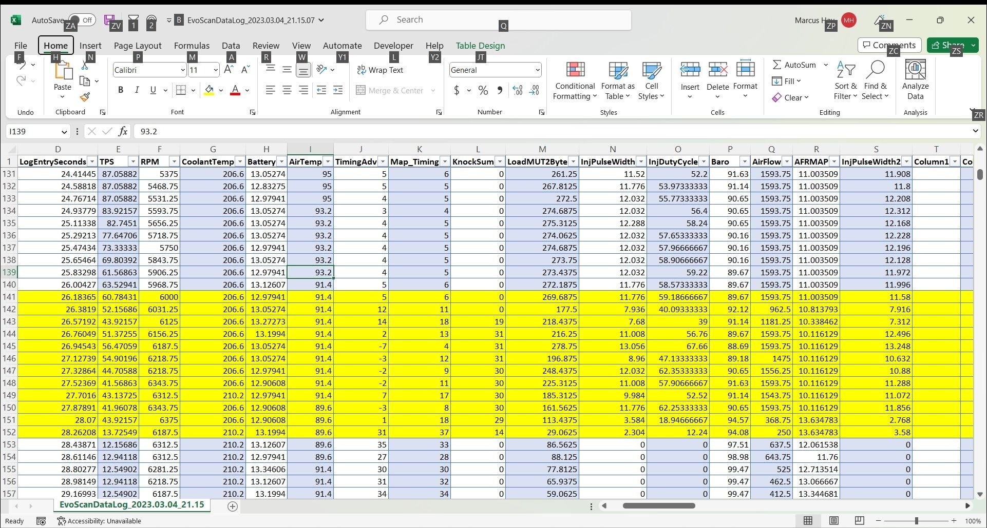

Has anyone ever seen anything like this? Evo7, if it matters. On this log the load value drops by 100 in an instant, resulting in massive knock. I am assuming this is a MAF error. You can see that the airflow Hz drops considerably, however I assume there was no actual reduction in airflow, hence the ECU looked up timing values too high for the current airflow and calculated fuel pulse width values that were too low. Unfortunately, due to an error with Evoscan logging the wideband, I wasn't able to log AFR. If I were able to, I would be able to confirm that the airflow didn't actually drop, since the AFR would go instantly lean.
I am wondering if there is anything physical, other than a MAF error that could cause this. I can't think of anything. Air would have to be bypassing the MAF, but any sort of boost leak would result in the engine getting less air than reported by the MAF, not more. However, it is kind of weird that the MAF would have a momentary glitch like this.
There is some oil in the engine bay, so this incident has likely resulted in damaged ring lands.

Yes - I've seen similar momentary MAF glitches and had to replace it to fix this twice in 250k miles.
OK, thanks. Previously, I was expecting if a MAF fails it would fail completely. I think I will recommend the owner switches to SD.
