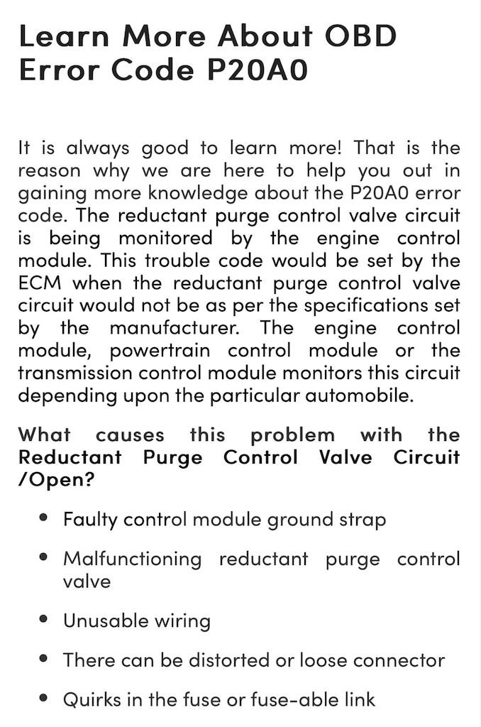

I happened to have a PCV valve that I bought a while ago. So I replaced it based on the DTC details my tuner sent:
Will see if this happens to be the issue as the PCV valve is original and I've read are prone to failures.
