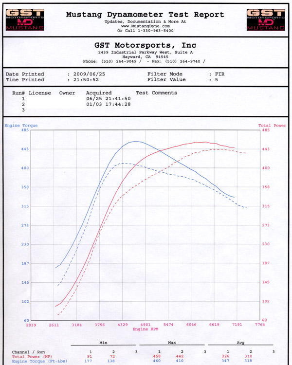

Brian came back in for a retune after moving to a 2.3L stroker, and oversized valves in the head (stock head ports still).
Car is now even more of a torque monster. Still on E85
Same peak boost as before (32psi) but 2psi less from 4500 to redline.
While tuning, the car hit 400wtq at only 24.5 psi, the same 400wtq took 32psi on the 2.0L.
huge gains!
Original post with stock 2.0L and full mod list here:
https://www.evolutionm.net/forums/ev...91oct-e85.html

Awesome Bryan!!
mega torque especially for 2.3 without any serious headwork!!!
that thing has to feel awesome!!!!!

It's ok Chad, it'd be way more "awesome" if the torque didn't take a nose dive like that. *wink* *wink* *hint* *hint*
