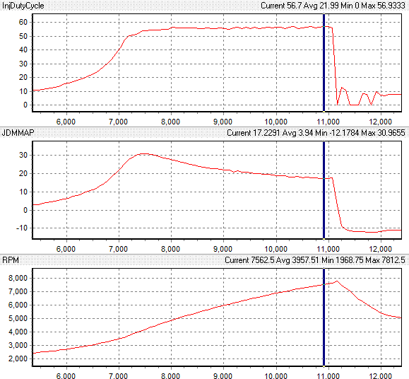

Originally Posted by PeteyTurbo@KHC
Thats awesome! Can't believe the OG green is out of steam.. Probably better off since the single pump probably is as well.. Good stuff.
Big motor to fill. The boost drops so much the IDC's are only at 56% max. IDC "curve" is basically flat at 56% from 5000 to 7500 rpm. haha

Crazy Tq. I find it weird that the green dies out so early on the graph.
It's a 2.4L and the OG Green isn't that much larger then a Evo 9 turbo.
For some reference, the highest OG Green on this dyno over the years has been 420whp, also on E85, but on a 2.0L
If I remember correctly, this very same car, with the stock 2.0L produced 415whp / 390wtq, the only difference between now and then is the 2.4L
