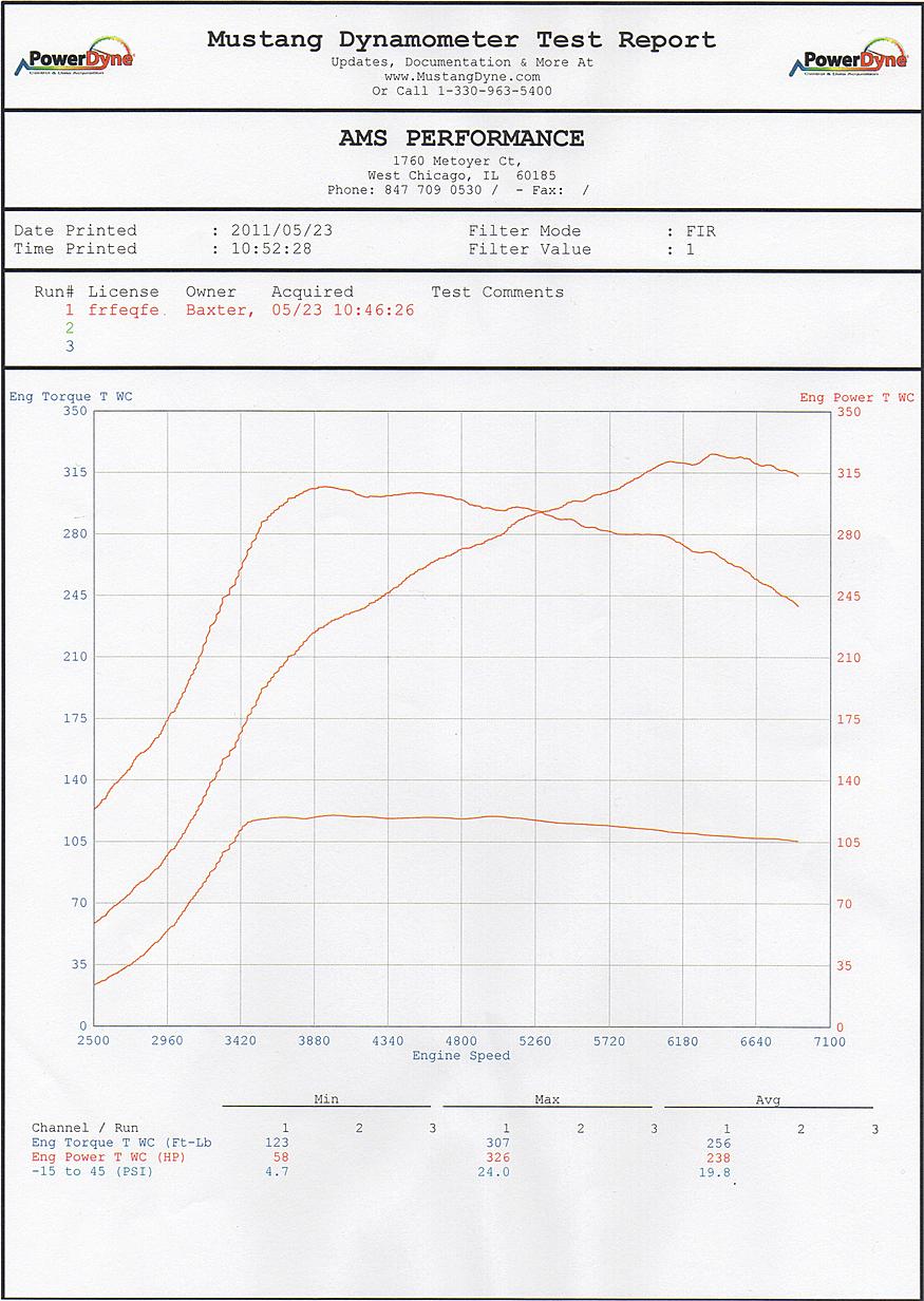

AMS tune results
Yesterday I had my first tune done by Mitch at AMS on their mustang dyno.
326 whp 307 torque at 24psi on stock turbo

Good numbers, particularly on a Mustang. What sort of mods?

Yeah, I'm happy with it! They said I would see at least an 8% gain if they put it on the dyno jet. Which would bring me to 352 whp.
So far I have the following mods: AMS tbe, Megan o2 housing, AEM cold air intake, Kelford 272 cams, Supertech dual springs and retainers, ARP head studs, AMS manual boost controller, and Walbro 255 fuel pump.

nice, stock fmic and licp, 93 fuel?

Yes to both

For InitialE: I see your at 327 whp, was that on a Mustang dyne?

It was IveyTune's Dynojet. I have a HFC installed that is costing me ~20 whp, but I am OK with it, as I want my car fairly quiet and emissions-compliant. As you said, you should be ~350 whp on a Dynojet. Nice result! .

Numbers came out great! Glad you are happy with the car thanks for having us tune it!

Strong 8, nice work Mitch.

I'd like to see you do a VD pull and post the results. Great numbers for your mods.
