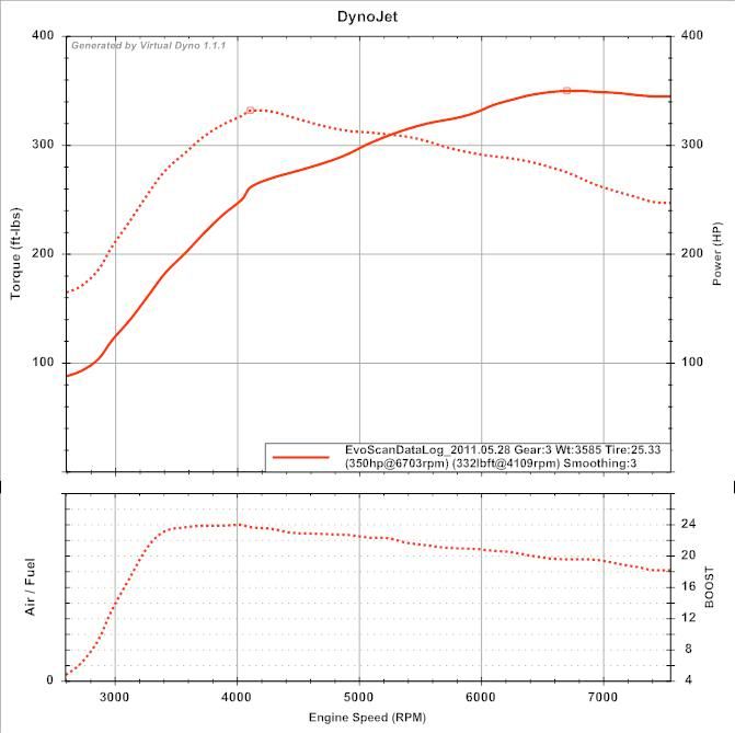

here my setup
3" downpipe
3"exhaust
licp et uicp injen
o2 housing
24peak
91oct (quebec
i want your comment
tell me if all seem to be good
tuned by myself

That is excellent.

Solid numbers. Very good low-end response.

that looks great. do you have a cat and are you running the stock front mount intercooler?

stock intercooler but i forget fuel pump 255 but stock injector
its an evo9
does anyone know the quartermiles time i could expect??

12.8 would be my guess

Thats pretty good. As far as 1/4 that depends on driver/tires. But it should be capable of mid to low 12's im guessing if not better. Correct me if im wrong.

I'm impressed at 24psi peak with no knock. What kind of boost control are you using?
I'm basically at the same point with my car, except no UICP and I have a grimspeed ebcs. I have to run on 90oct (crappy alaska gas) but I have a meth injection kit that hopefully I will get to start tuning on this week.
My baseline run was 12.72@108 with a 1.78 60ft. That was just with a tune and drop in k&n filter.
I'm hoping to crack 11s on a cold day with the meth injection but we will see.
