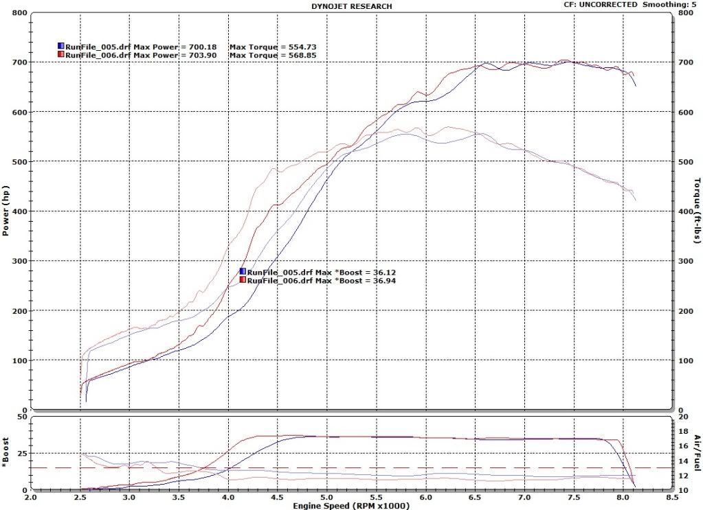

very nice! spools really nice too

They are just the 12mm cams I run, we are working on a name as I am not allowed to call them S2R as a product name. On a smaller turbo I dont think that they would work as well but it is dependent on headflow. I dont think they hurt spool necessarily but they dont help it. I make 21psi at 4200 as is though.
Aaron
In this particular case, would you define an FP Red as a smaller turbo?

Anything smaller than a Black, the Red might work out okay but it would definitely be on the small side. Then again I think there is a reason my car makes the power it does with as many off the shelf parts as it has. The 2 big things that separate my car from Anthony's are the cams and headwork. The compression ratio I dont think hurts it as much really, breathing is WAY more important.

Just saw this thread & this thing must haul *** on the freeway (or anywhere for that matter)! Its pretty cool when you see 400ft/lbs by 4200rpm with a man-size turbo too The 2.4 is no joke. The owner should be very proud of this and great job ER as usual

Load on a dynojet makes a big difference in spool if the load control is turned off.
