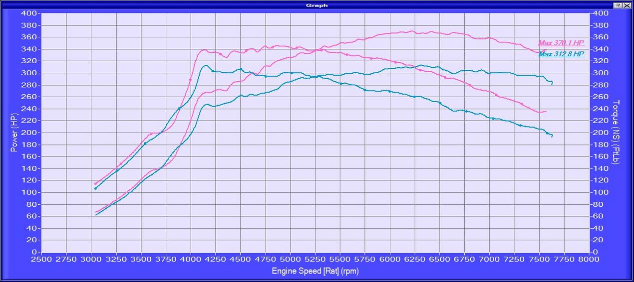

Here is my mod lists:
HKS 272
ETS 3.8" garret core
ets licp
perrin intake pipe with OMG air filter
ARP headstud
Fujitsubo rma01 exhaust
Milspec 100 cell cat
Tanabe dp
Ported exhaust manifold by Milspec
Map o2 housing
walbro 255
RC1200cc injectors
Unknonw MBC
Home made COP KIT-using RSX ignition coil
FP 18psi wga
With 91- peak boost was at 25 tapper to 22
With e85-peak boost was at 28 tapper to 24
The car was tuned on the dyno dynamics.
Attached Thumbnails Evo 8 71hta 91/E85-a4rontran.jpg   Evo 8 71hta 91/E85-a4ron-afr-boost.jpg

Nice. I too have a 71hta and really enjoy the stock like response. Dyno Dynamics sure can be heartbreakers can't they

yeah, but it doesn't really matter, when car pulls like a beast. LOL

Great numbers, ride must be a blast. Any plans on 3-port? and what pigtails did you use for the DIY COP?
