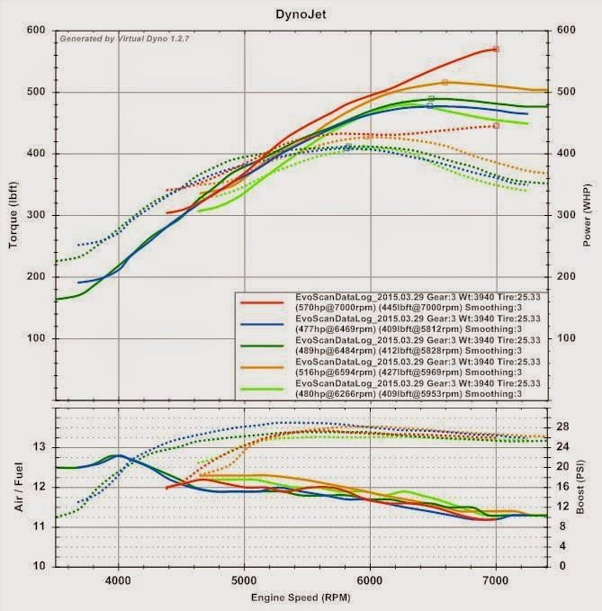

This was my first time using virtual dyno to make a graph like this so be nice
Update: 3/8/15
Installed an FP Red and GSC S2's. This is by no means done. There is still a ton of work to do. We finished installing the parts at 2AM. We went out to do some quick pulls and adjustments to get it driveable and what not. Injector duty cycle is in the mid 80's and I am still on one 255 pump. Will be installing a double pumper this weekend and then we are going to do some fine tuning and up the boost some more. Right now this is only on 25lbs. More to come....

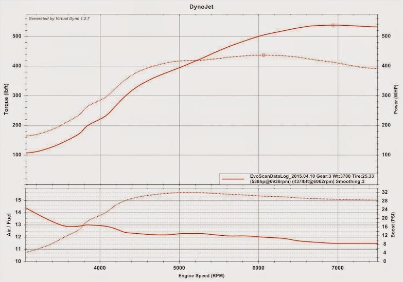

As of 4/10/15 this is where we are at. Should be done for a while.

Quality parts and nice numbers- but that boost curve looks off yeah?

It the stock 9 turbo, its just out of breath. We messed with the wastegate tables for a while to try and get it to hold more pressure to prevent that taper but it just wasn't having it. Turbo is just flat out of breath.

I guess it's just the resolution of the graph- makes the boost taper look more drastic than usual. I wonder if different o2 housing w/ an external wastegate would help?

Updated with new turbo/cams and dyno graph. Will have more updates this weekend!

when did you start the pull on the Red?
Do you have the part where is come up into the power band? I'm interested in where it crosses the 300 WTQ line!

Those were probably started around 3500 rpms. Didn't really get any good logs that night.
Did get the double pumper installed last night. Should be back at it this weekend and should have some good graphs to show as long as weather permits.

Ahh gotcha, that's the reason Im sure for the lazier torque curve.
Looks like once you're into the 4500-7500+ range its a lot of fun though!

Got the double pumper in and a little more tuning in. Then it started to rain so we called it a day. Ethanol content was about 72%. Still have a little more to do...
