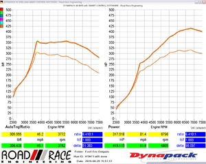

Well it took longer than expected but GSC S2 cams were finally installed and tuned.
91 octane, 24 psi, cutout closed and open
E85, 26 psi, cutout closed and open
New parts added: GSC S2 w/5041 springs and retainers
FP manifold
Stock catback was put back on with electric cutout in place of test pipe
Just wanted to share my results and wanted to know what you guys think. This is on both 91 octane and e85. GSC s2 cams with valve springs and retainers are next on the list.
Mod list:
Stock block and Head(Stock cams)
FP 84mm 71hta w/ 18psi wga
FP 84mm intake pipe
3" TBE
Muse 02 dump
3 port bcs
Synapse DV
Vrsf 3.5" intercooler
Muse licp
Walbro 255
RC 1200cc injectors

The stock cams are definitely hurting in the high rpms. The GSC S2s will help a lot.

Is this a fairly conservative tune? I only ask cause on the same dyno with the same mods I made 450/400 on E85 also on stock cams. There's more to be had in your setup, unless you want it conservative

Quote: Is this a fairly conservative tune? I only ask cause on the same dyno with the same mods I made 450/400 on E85 also on stock cams. There's more to be had in your setup, unless you want it conservative
I would think so as I'm sure the stock turbo can put close to those numbers down but with a lot of boost. How much psi?

Quote: I would think so as I'm sure the stock turbo can put close to those numbers down but with a lot of boost. How much psi?
On my 450/400 E85 map I'm running 30psi tapering to 27.5psi by 7500rpm. Nasty little setup
