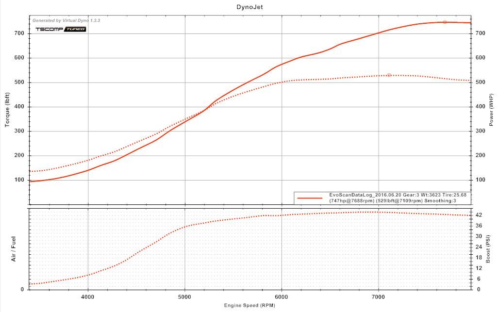

Right now there is no blending set on this car, But I will update with a final result once we enable that and extract a little more power yet from the car. At the power level its at now it should trap around 145. I trapped 148 with 780 only in my personal car.
We built the entire long block, And kept the head porting as is, since I seen absolutely no need to touch that.
Mods are:

Current results are as follows below. Id like to get this car around 770-780 range, But the summer heat certainly makes that hard to accomplish on this setup. For now, Here's what it makes with these boost levels safely.
