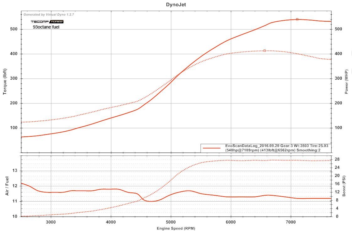

Graph of power:

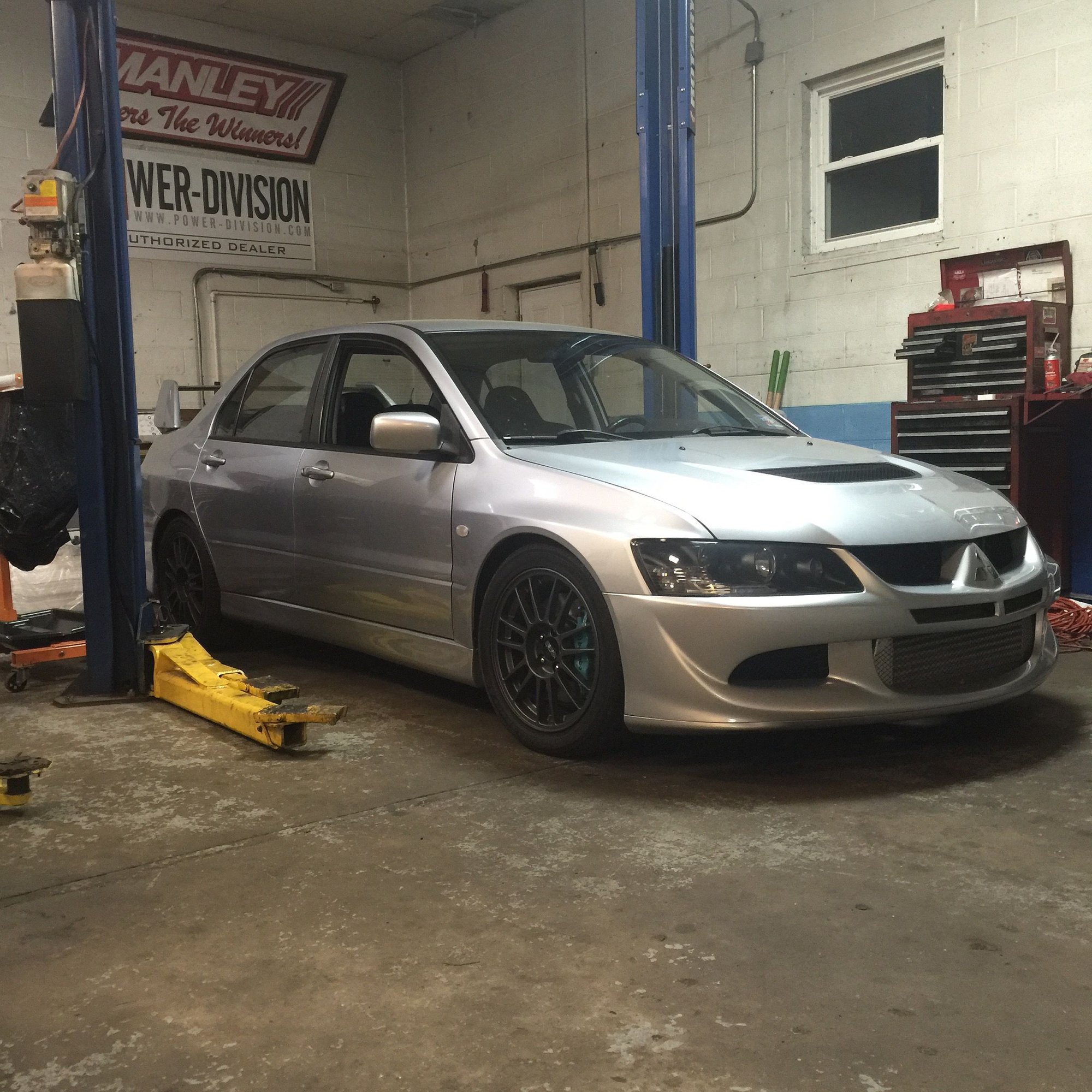

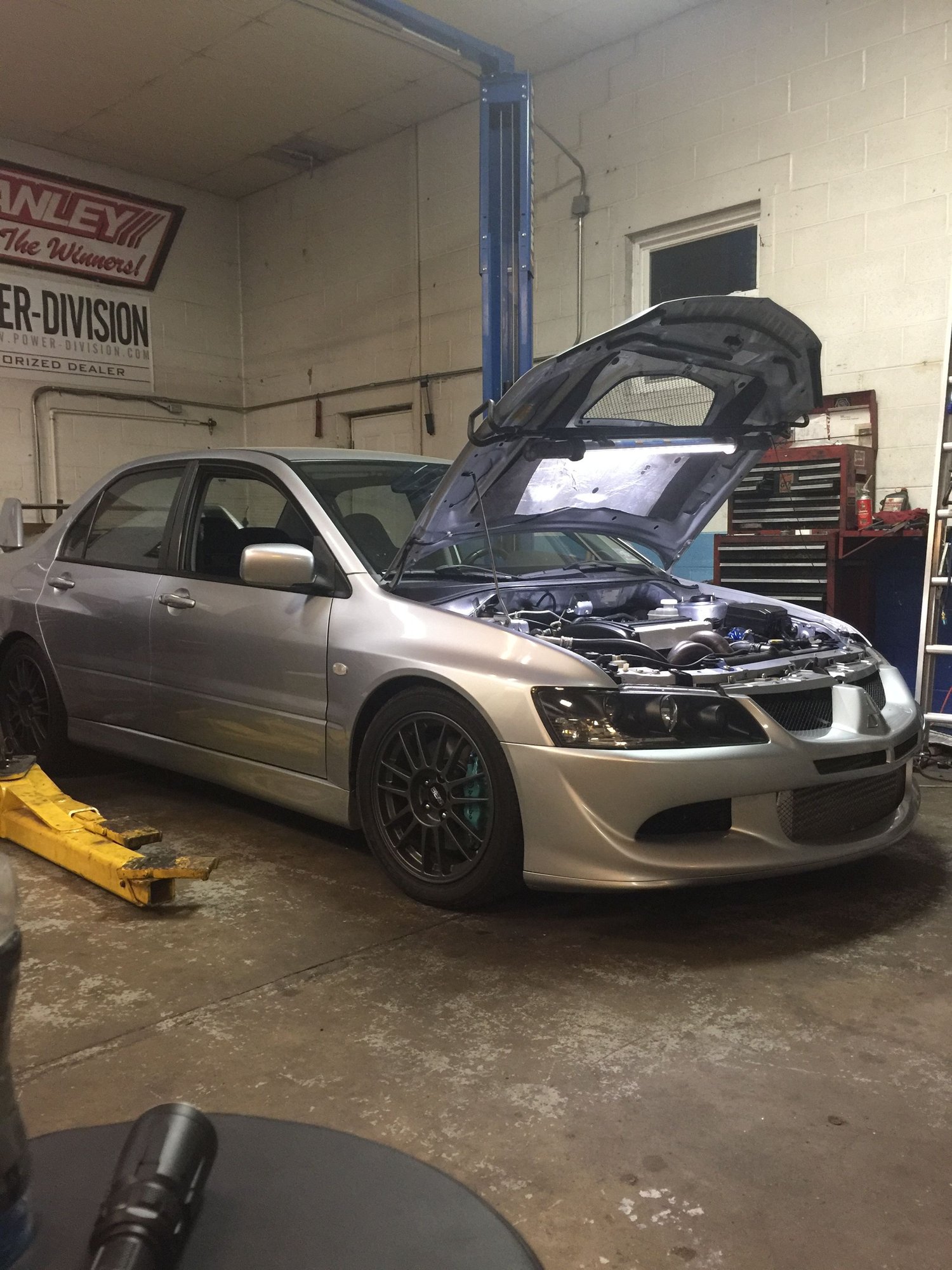

Some pics of car at shop:

Thanks Tom, overall i'm extremely happy the way the car drives. Driving it home today I had a huge smile the whole time lol. Its a night and day difference after the boost leak test and locking the tune in. At this power level i feel its perfect for a street setup. I'm interested in the fitronics in the future though. I can't say enough how happy i been with this motor build. Its so quiet for a built motor. No catch cans. Most people get so surprised when they find out its a built 2.3L. This speed density tune is amazing. It drives effortlessly and the powerband is amazing. Tom and the crew at TSComp really put their heart into everything they work on!
