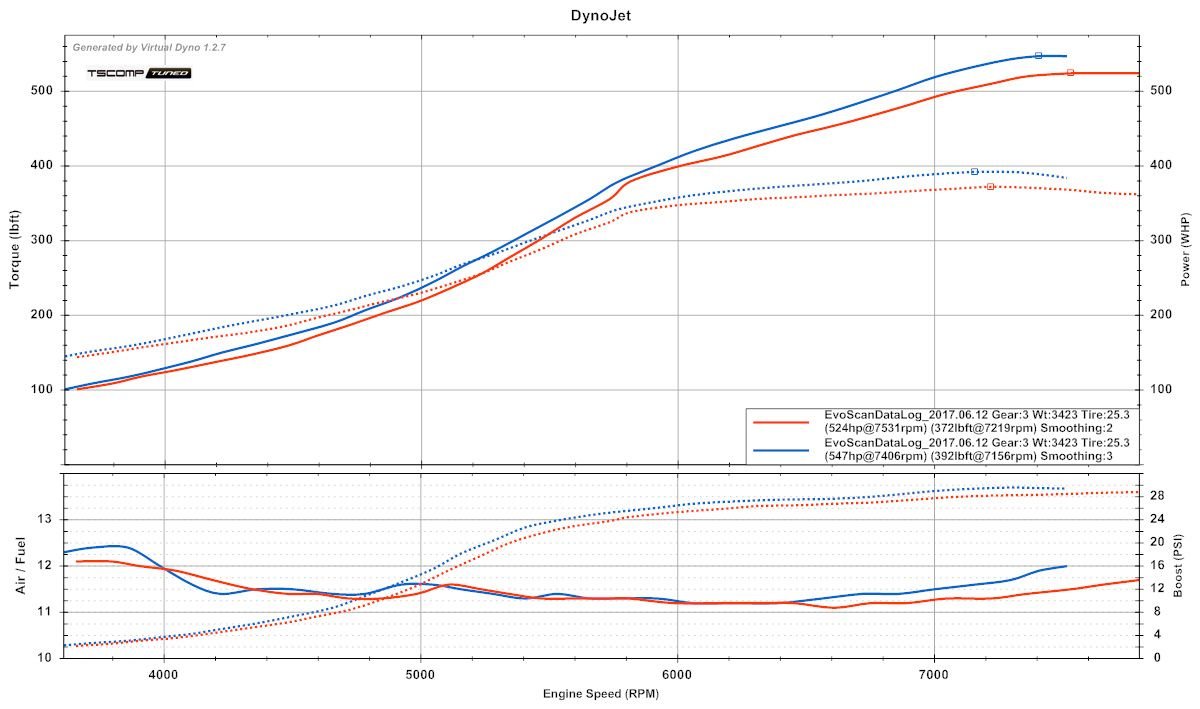

E85 graph (I left the car with the red line to be extra safe):

Was the goal to see how late it would spool?

Look at the graph closer and tell me if you can see why its not starting at the RPM you think it is and its trimmed off. Pulls were started at 2000RPM in 3rd on the Evo IX 5 speed.

I understand that this is a black ss housing on a stock block. Tappering up the boost is common. My point is, why even run this turbo at such low boost, seems useless and no fun.
