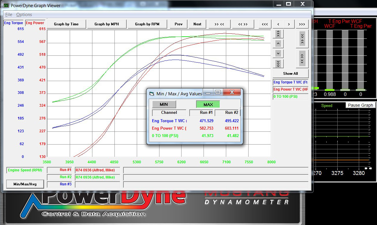

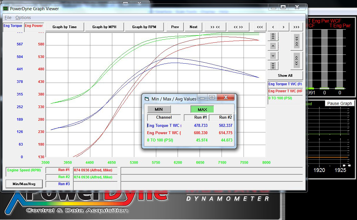

All comparison pulls, ranging from 36psi to 45psi, resulted in the Morrison Fabrications manifold gaining between 20-30whp and 12-24wtq during full boost over the FP manifold. Before 5k rpm, there is no appreciable power/torque difference between each manifold.
The 36 psi pull, which is wastegate pressure, gives perhaps the best back-to-back comparison as the boost stays extremely close to being the same (green lines on the graph, darker green being the Morrison Fabrications). In the later 40 and 45 psi pulls, the boost control duty cycle was not changed to account for the Morrison Fabrications manifold and ended up at a lower psi throughout the pull compared to the FP manifold.
The Morrison Fabrications manifold made more power despite less boost.
36psi, wastegate pressure, with boost levels almost identical throughout.
40psi, with boost on the Morrison Fabrications manifold (dark green) being lower after 6200 rpm (commanded/fixed BCS duty cycle was not changed).
45psi, with boost on the FP manifold (light green) being higher after 6650 rpm, and the Morrison Fabrications manifold being a little higher from 4500 to 6500.

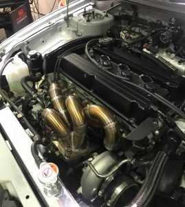

The Morrison Fabrications Evo 8/9 Stock Replacement manifold is small runner to best match stock frame Evo offerings. This is, of course, with our oval port head flange, and all gently formed and seamless transitions throughout. Form always follows function in everything we create and although we initially ignored the “look” of this piece to allow it to emerge as we followed our strict requirements, it produced something beautiful. There isn’t one part of this piece that we aren’t proud of. It accomplished everything we hoped it would. Hope you enjoy it as much as we do.

- a collector that mimics the angle of entry of the turbine housing, giving each runner a direct shot into the turbine volute;
- no tight radius or cheated/compromised bends (specifically runner #3 off the port); and
- equal length primaries sized to match bolt-on Evo turbo offerings.
