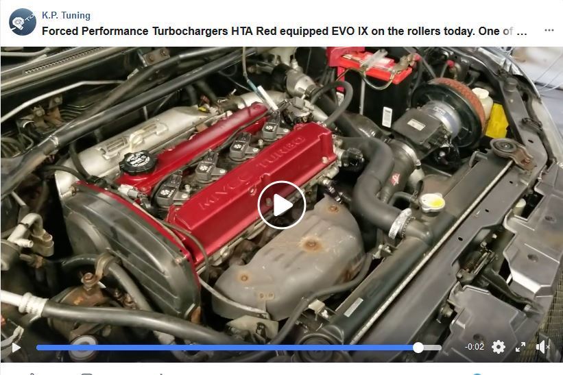

Originally Posted by 2006EvoIXer
In your video, what is that air sound kicking up a notch about a second after each gear change? Sounds like some sort of air leak after boost hitting a certain pressure.
On my phone, it's at the -26, -23, and -18 second marks.
It's a GIGANTIC air leak, It's an open dump

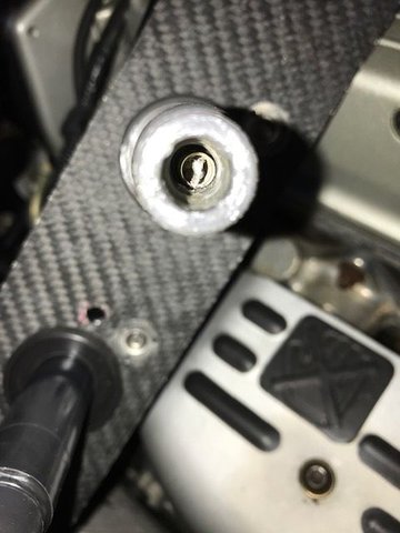

Here is a picture of my COP setup. Is it the older or newer revision?

I think the older versions were the ones you couldn't fit the spark plug cover on. The connection to the coil would angle up instead of being parallel so that the cover can fit.
Maybe someone can correct me if I'm wrong.

Just to follow up - it would be difficult to determine just from looking at the assembled system to tell. I want to say I bought mine in 2012. I'd be willing to bet you have the short coils. I'll attach some pics for reference.
See the height difference between old and new. Simply put, more coil spring pressure makes a stronger electrical connection. I know it just looks like he stretched the old springs but they fit much more snug as well
If any of your components have this type of appearance below, your ignition system is not optimized. I initially thought it was a design flaw and moisture was finding its way in and causing corrosion, but I shared these images with Matt and he explained how he's moved to a longer coil now and that the corroded appearance was caused by arcing due to less than optimal connection between coil and plug.
You can see the greenish color on the plug terminal and the gunk buildup on the coil. I had a great improvement from switching coils and by reducing gap. As others have stressed that is likely a major player here. However, you owe it to your new setup to freshen up the ignition while you're pulling plugs. If your plug terminals and coils aren't clean then you could use the new coils. Send Matt an email, he will help out
Amazing post and something I had not been considering until you pointed this out. I reached out to Matt at Spoolinup and he said to mail back my system for a free checkup which I will. My Unit does indeed fit under teh factory Mitsu Cover which I like FWIW.
