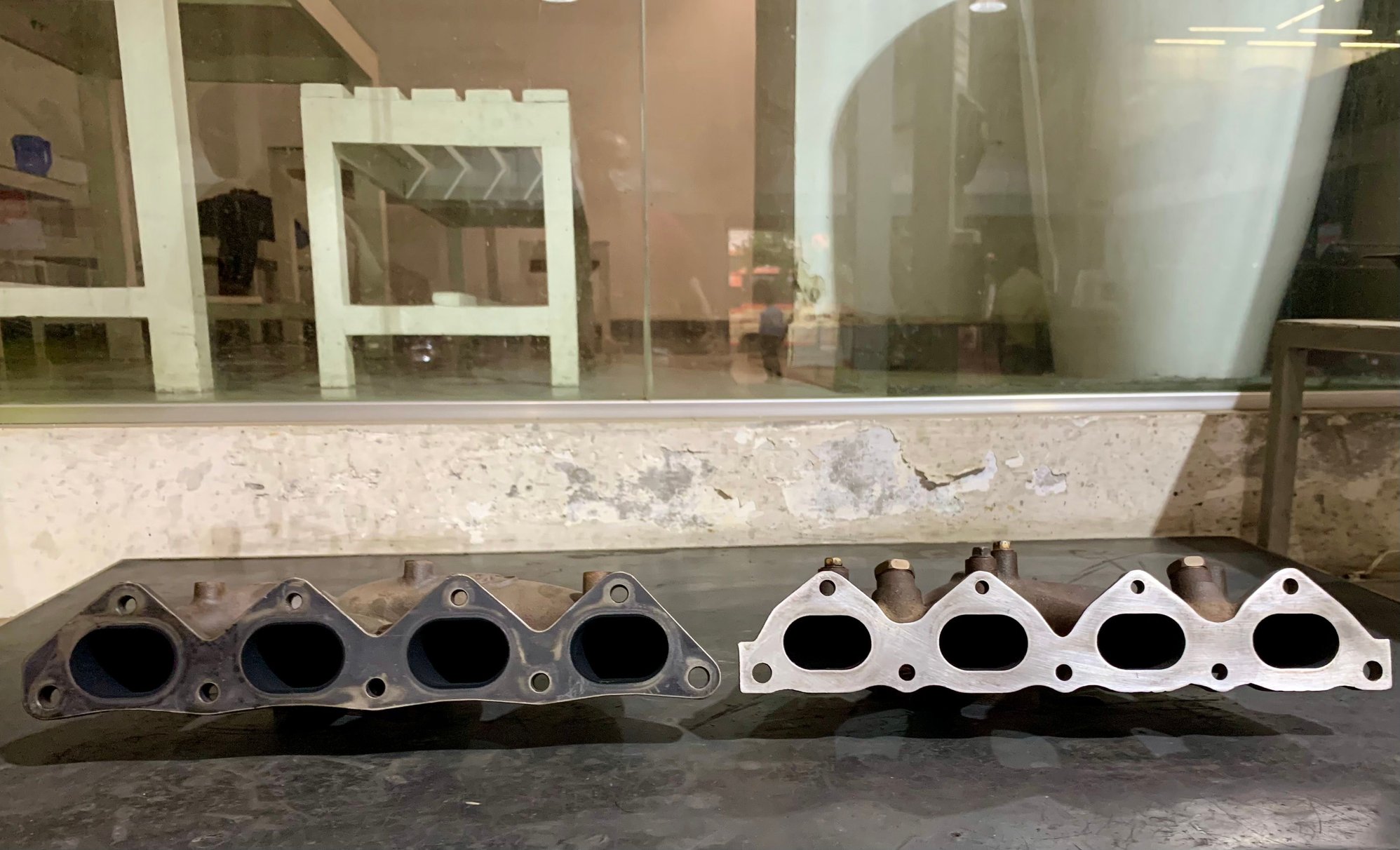

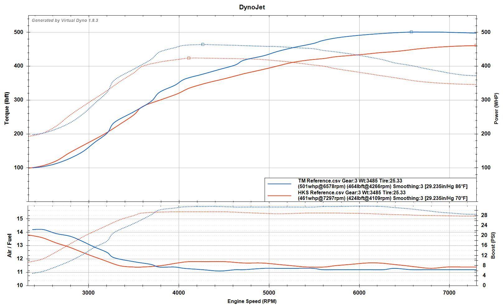

alpinaturbo got me thinking on my slow spool buildup (12.5 psi to 32 psi) and I thought i'd check 2 things hardware-wise to see if I can make any improvements. One was the exhaust manifold and the other is the WG actuator spring. I'm using turbosmart WG actuator with 16 psi spring and FP cast iron race manifold which has 20% larger runners compared to stock mani as advertised by FP. My theory was that the stock mani with narrow runners might increase velocity and promote spool while sacrificing some top end.
So, had some free time today and thought I'd do some testing on the exhaust manifold. Result posted below for reference. I was a bit shocked to see how much the FP manifold helped with power and spool.....
Took some pictures today as well of both manifolds for runner and port opening size side-by-side comparison.
Please note: Running a Tubular manifold is not an option for me as temps are around 100 degrees ambient for 9-10 months of the year here in Bangladesh.
Stock vs. FP cast iron race manifold

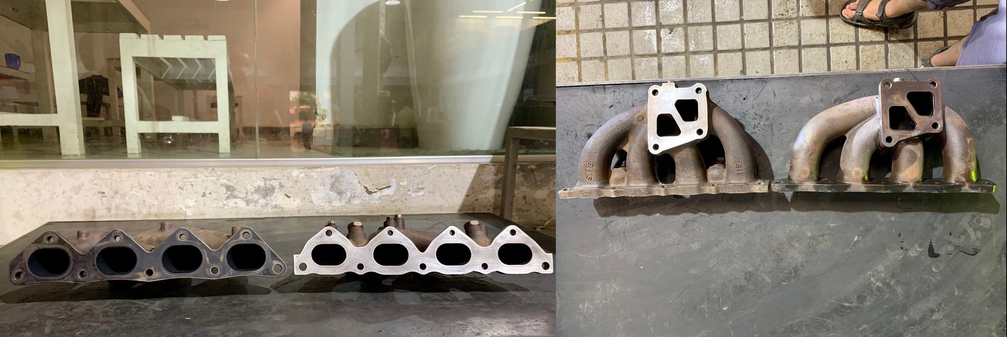

Did some further research on the stock vs FP manifold today as I was really shocked by the result. Found something very interesting.
- Evo 7 & Evo 9 manifolds carry the same part number but in reality is different in design and size
- Evo 7 manifold runner opening is much smaller in size compared to Evo 9
- True comparison between Evo 9 stock manifold & FP race cast manifold might yield a different result.
The manifold I installed for testing was borrowed from a friends evo 7. Attaching pictures below showing difference between Evo 7 & 9 Manifold:
Evo 7 vs FP race cast manifold (pictures taken by me)
Evo 9 vs FP race cast manifold (pictures courtesy of Raceghost post)
Difference between Evo 7 vs Evo 9 manifold

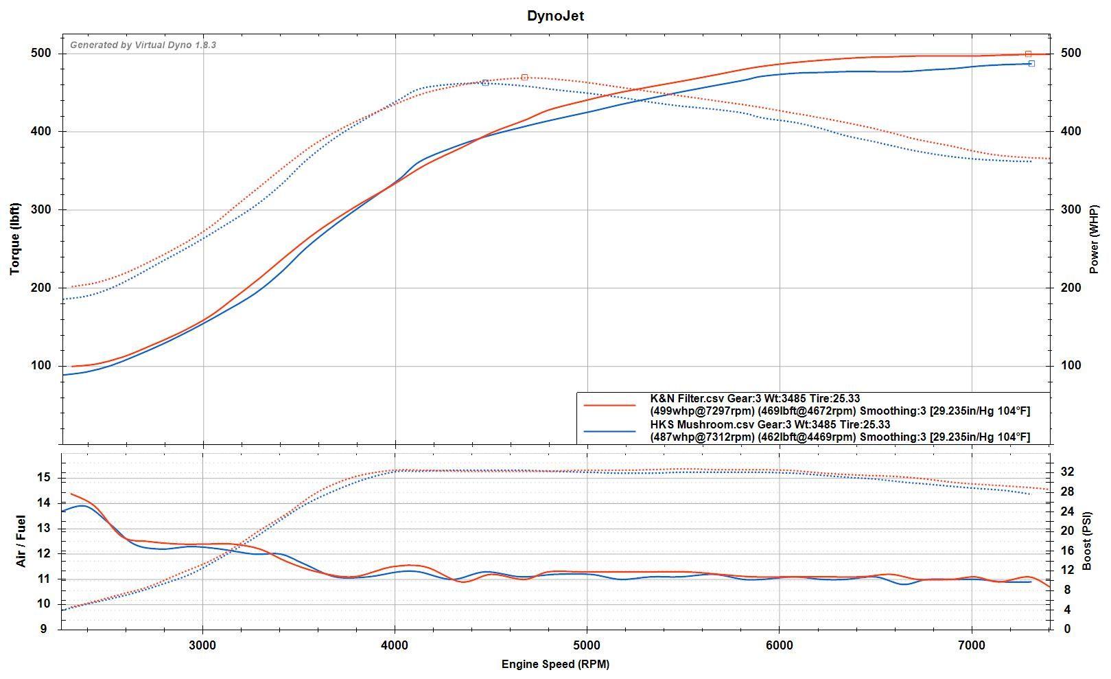

As suggested by my local Evo buddy Ehsan, I thought i'd try my hands on a new air filter setup. My current setup contains:
- Tomei suction pipe
- Custom MAF delete
- HKS Kansai box
- HKS mushroom air filter
Inspired by the pictures from another post here at Evom, decided to try the FIPK kit from K&N (K&N 57-5504-1) which is made for the DSM. But the post suggested that the kit would fit nicely in the Kansai box. And it really fits nicely . Pictured down below for reference.
Now, on to the performance:
- About 10hp increase to the wheels. Similar torque
- With the same tune, overshot the PSI target. Later changed the WG duty to match the boost curve
- Butt dyno also attests to power increase
- Maybe it's my imagination, but the car sounds like its smoother / happier post 6000 rpm.
Pictures below of VD for HKS mushroom vs K&N same tune and then later same boost curve.
Also, sharing previous vs new WG duty curve to attain the same boost for reference.
Loving the new K&N setup so far. Thanks a lot Ehsan
Same tune...boost overshot target PSI
WG compensated to reflect same boost curve
Previous vs new WG duty to attain same boost
