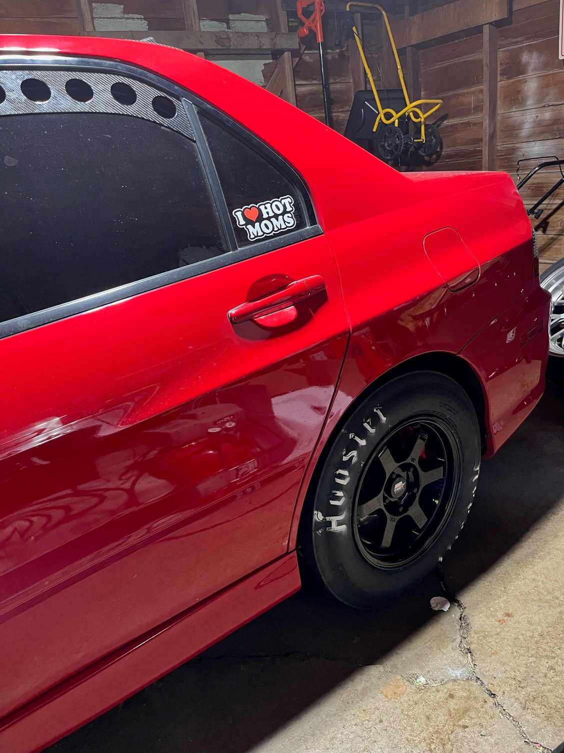

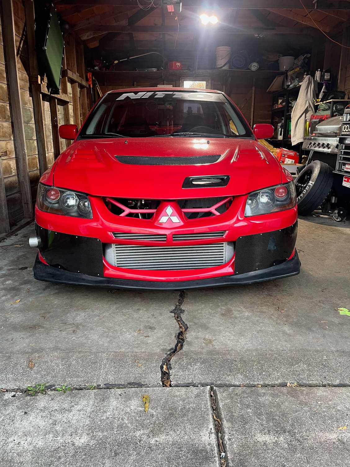

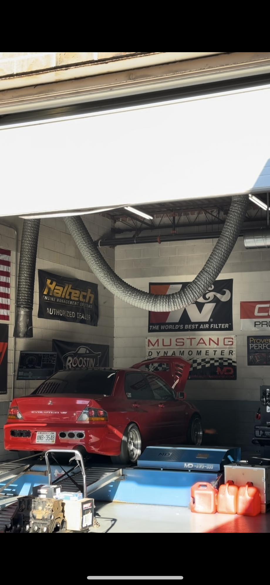

So after an 8 month build, I finally got my evo 8 tuned at Boostin' Performance. She made 635hp and 554tq corrected at 35psi on E-85 on their mustang dyno. Devin is a super cool dude and really helpful/intelligent.

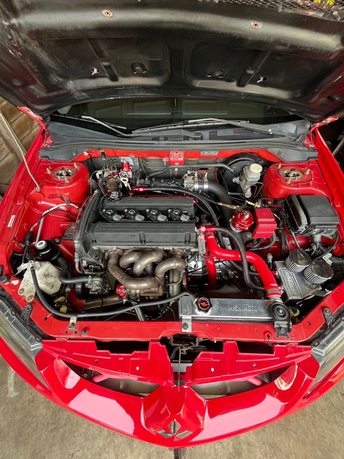

I did everything myself, aside from the tuning obviously. I got some slicks at home and I'm hoping to make a 9.9 second pass in the 1/4 mile in the spring; but I'm still on the stock drivetrain. I also shaved off over 300lbs and the car weighed in at 2,890lbs without me in it. This thing RIPS!! He also enabled No Lift Shift which is super nice but it's taking me a little bit to get used to it. It redlines at 7,800 and 2-step is set at 6,000. Hands down the fastest car I've ever been in. I've always dreamt of having a 1,000 horsepower evo, but after driving this thing I couldn't imagine what that would feel like. Anyways, to all my midwestern folks, I'll be racing at Great Lakes Dragaway in Union Grove, WI. I might upgrade the transfer case over the winter and eventually I'd like to get a dogbox. Here's the build list.
BLOCK:
4G64 87mm bore
Wiseco 1400HD Pistons (9.4:1 compression) (Top ring gapped to .022", Bottom ring gapped to .026")
Manley Turbo Tuff I-Beam Rods (ARP 200 bolts)
Stock 4G64 Crank
ARP Main Studs
ACL Bearings
HEAD:
GSC S2 Cams
Tomei Adjustable Cam Gears
Kiggly Street Valve Springs/Retainers
Kiggly HLA
ARP Headstuds 8740 Chromoly
Cometic Head Gasket
TURBO:
FP Black Journal Bearing (SS Housing)
MAP Exhaust Manifold
Tial MVS 38mm WG (20psi spring)
3" Exhaust
FUEL SYSTEM:
Dual Walbro 450 Pumps
FIC 2150cc Injectors
FIC Fuel Rail
Aeromotive FPR (set to 43psi at idle w/ vacuum hose disconnected)
-8an Feed
-6an Return
Hobbs Switch (turns second pump on at 15psi)
IGNITION:
R35 GTR Coil On Plug
BPR8ES Plugs (gapped to 0.18)
INTAKE/INTERCOOLER:
OEM Intake Manifold
S90 &0mm Throttle Body
Injen Lower IC Pipe
STM Upper IC Pipe
Tial Q BOV (8 psi WHITE spring)
MISC.
Speed Density Kit (GM IAT and Omni 4bar MAP sensor)
Spoolin Up MAF to IAT Harness
Greddy Electronic Boost Controller
-10an Catch Can
