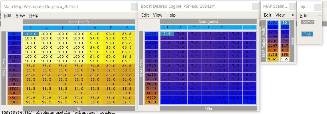

I tried to log/fix some stuff using chat gpt. I then looked at ECU and it seems weird to me when I compared with other maps.

Here is the ECU I had on my evo which seems weird to me: https://jumpshare.com/s/Ku4SHMw0oR2IqvTdZ8sR
Here is one ChatGPT made for me: https://jumpshare.com/s/obK97r7Jgkimk78fPMEp
Any inputs?

unplugging a battery will not cause any maps to be deleted or changed...
it will only affect LTFT
don't use ChatGPT for maps, lol unless you want to blow up your motor...
changing random value's is useless without proper logging, your BDE is low ,but probably your correction is not set, so it's using pure WDGC duty
If you send me your rom i will take a look when i have time, to see if it makes sense
