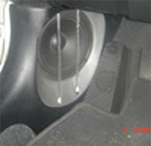

I didn't lose my dead pedal with my kick panels

Did you do those yourself? Fiberglass?

Yes, I owned a shop for 14 years that did high end competitin work. I was always looking to do something different and that was the result for my car. The speaker is built to work well in a sealed enclosure and it has a silk cone. I made the stock kick larger because it didn't extend to the firewall and then glassed it inward towards the baffle around the speaker. The acrylic rods are me "grille" and can be lit. I'm pretty happy with how it came out being the little time you ever get to work on your own car.
