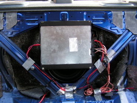

on my viii and going on my ix, bolting up two amps on the "V" stock brace of the trunk thru panel. You'll see it when you take the cover off. Measure and drill for vertical installs. Frees up a lot of room on the trunk floor. I then put back the rear strut bar which act as barrier against damage to the amps.
when you bolt up the amps, pre drill the brace and the carpeted cover. Put back the cover then bolt the amps for clean install. You can snake all the wiring to the trunk corner from interior flooring.
I'll have to post the pics when I'm finally done. It's taking forever!!!
BTW, make sure you pick lighter amps! I got two Eclipse newer amps. Small footprint and light!

Originally Posted by Inprogress
Please do post pics spyderx, I'ld like to see what you did.
Same style install like the pic above, except I have two amps.

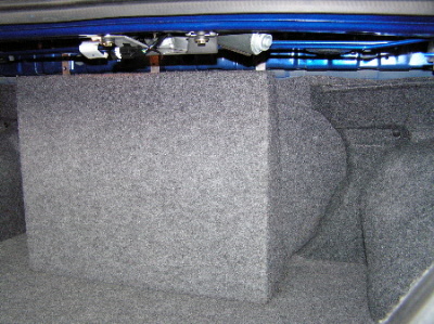

box is 26L and only weighs 4kg.
Attached Thumbnails Amp Locations-copy-misc-023.jpg   Amp Locations-copy-misc-042.jpg

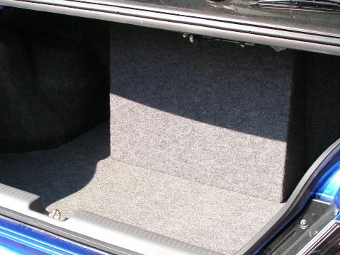

I've bolted it from the front (2 bolts) and also 3 brackets at the rear (top of box) onto support underneath parcel shelf (I think OEM strut brace), afterall this car can cornor fast
Attached Thumbnails Amp Locations-evo2007-029.jpg   Amp Locations-copy-evo2007-008.jpg

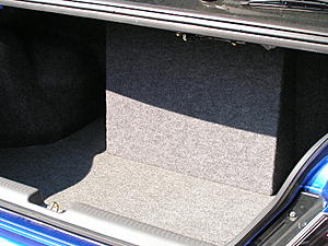

:d
