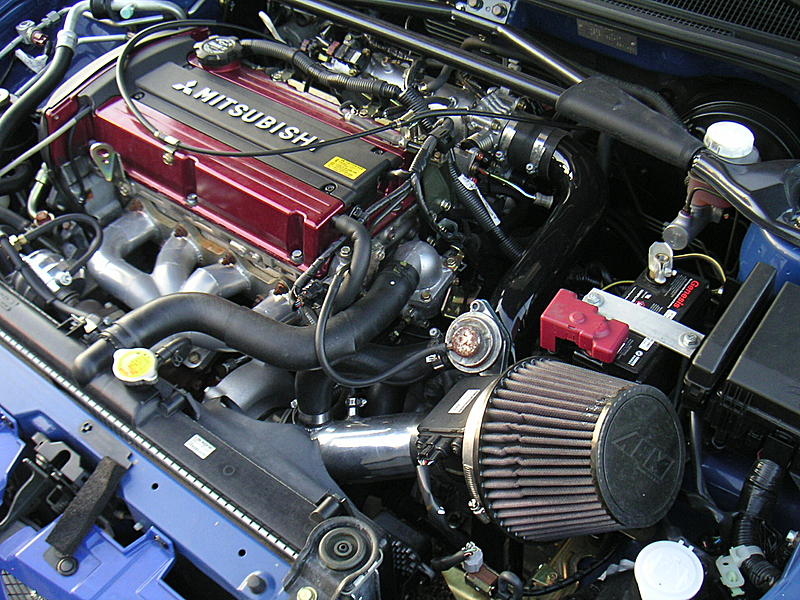

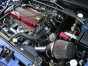

Not sure how fancy you'd like it to look, but have you considered making your own?
Aluminum stock is very easy to work with even if all you have is hand tools, you can polish it, and you can get it fairly cheaply at any hardware store.
Sorry I don't have a better pictures of it up close, but you can see the final product in the attachment.
As you can see, the top is simply a piece of flat bar stock with 2 holes drilled through it. The bottom of mine was welded using flat plate and some L-stock, but if you don't have access to someone with a welder, you could just as easily make the whole bottom out of a single piece of flat plate. Just cut to the appropriate shape and bend it. Basically you're looking at a rectangle that covers the whole area of the bottom of the battery plus a little extra length for "wings" on each side to hold the battery in place (short sides) and to bolt the tie-down strap to (long sides).
For example:
http://www.strathmoreartist2.com/ima...box_top_lg.gif
I have no idea what this is actually for (just found it on Google) but it shows the right idea...you'd cut a plate such that the area of the bottom of the battery fits in "Box Top". Cut out "Glue Flap" and throw those little squares away. On 2 opposing "side of box top" flaps you would drill and tap holes for the tie-down strap. The other 2 opposing "side of box top" would be bent upwards to hold the battery in place.
