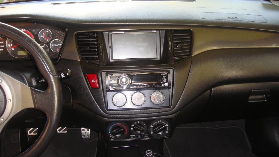

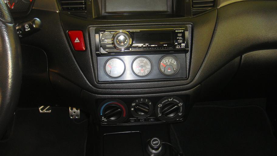

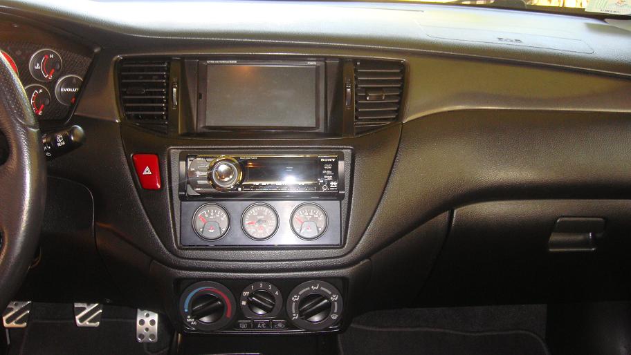

Hi, I did that mod a time ago but after idle issues and A/C not cooling enough I decided to create my own Orbital look alike HVAC kit. It is way better and easier because the evos HVAC is much more electrocnic (ECU behind the knobs)than the analog Galant or Montero controls.
I'll post some pics.

Some pics. Do you see something strange?

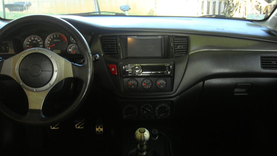

A few more pics...

Yes I cut the original HVAC and welded it using resins and fillers to the lower radio relocation kit. If you remove the hvac you'll see the rectangular shape that you must cut in order to built it right. Just cut along it and start trimming the lower part bit by bit.
I got the upper dash parts from a taiwanese friend.
Google for global lancer taiwan.
Old Sep 1, 2009 | 03:30 PM

For the upper part just buy the JDM upper bezel.
part # mn151278ha
visit. www.japanparts.com
