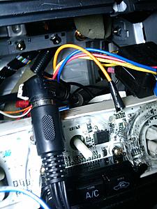

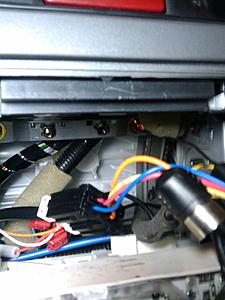

these pics should help the, the wire that comes from the amp is the round looking plug thing, that's what idk how to hook up, the radio that's in the car already has plugs for it but the one i wont to put in dose not, what should i do help install radio-2010-02-15-14.39.44.jpg

what is that round plug do for the amp?
the only plug i seen like that was for an antenna

i think its the wire for all the speakers not sure how to hook it up to the head unit

are you talking about the output wires? make sure they are connected to output and not input

Originally Posted by timmycat
anyone have any suggestions ? still trying to figure it out
If you have the factory amp setup, then you need the correct wiring harness.
Metra 70-7003 (70-7004 is the same as well)
That adapter allows the ground, constant, accessory, dimmer, etc wires to come from the more 'traditional' adapter.
The smaller round plug adapter has RCA low level inputs that need to come from your aftermarket stereo, as well as the blue remote wire.
Most quality head units have a low level out, fronts, rears, subs, etc. so that is simple, if your head unit does not, you'll need basically a line converter to take a speaker level output (from your aftermarket stereo) and turn it into a line level output, to plug into those RCA jacks for that adapter.
If you didn't get the 2nd adapter (small round one) then you'll probably need to pick it up seperately, if it is offered that way, I'm not sure. I just bought mine for $9 shipped for the both adapters.Does that clear up your confusion?

still stuck the radio i am putting in dose not have the 4 plugs on it so how do i connect the amp wire to it? the wire harness only works for radios with the 4 plugs on it
See the bolded text from my original post for you timmycat.
Something like this should solve your issue.. taking high level (speaker) outputs from your head unit, and turning them into low-level outs.. so basically.. from aftermarket stereo.. to this converter... to the RCA plugs from the above-mentioned harness... to the existing plug that routes to the factory amplifier. Clear as mud?
