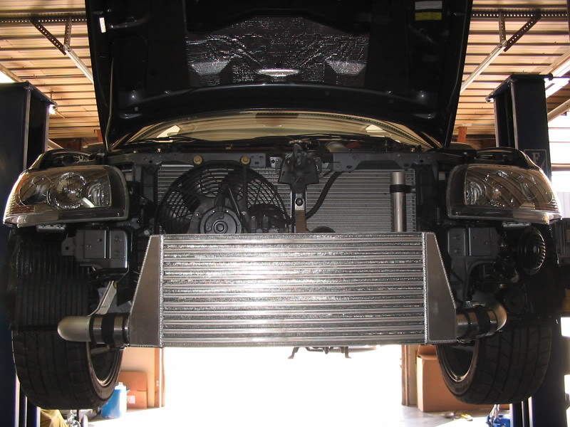

If you look just to the right of the core support for the FMIC, you can see one of the stock horns peeking out. The other horn is on the lower right, replaced by a Hella in the pic.
The stock horn next to the Hella.
