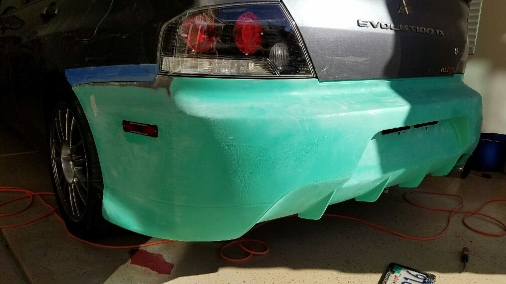

UPDATE!

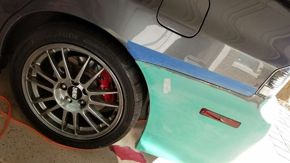

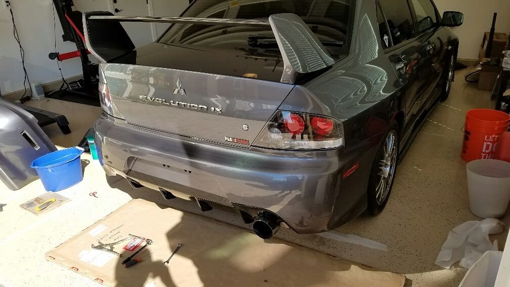

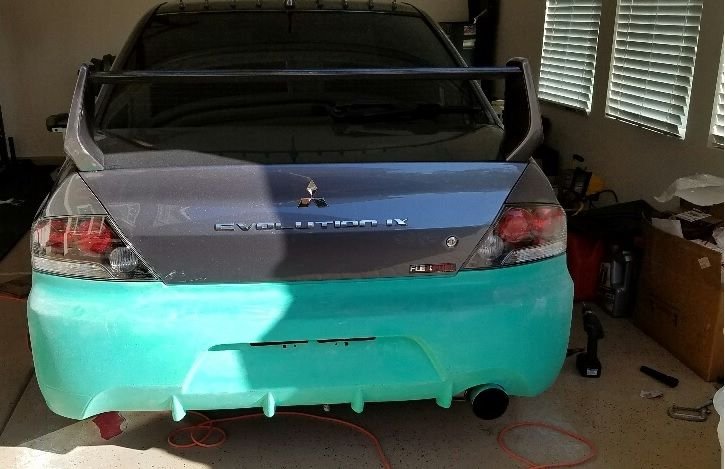

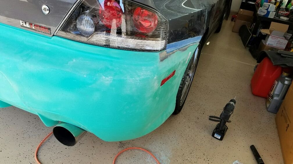

Picked up the bumper last Friday and immediately began working on it during the weekend.
If you're fitting it yourself like I am you need a dremel tool and sand paper. I used 3M 100 grit to help contour the sides to the tail lights. The dremel tool is to shape the side marker holes and cut away a place to put the license plate and form mounting point access channels.
Take your time with this. If you have any doubts, just take your car to a body shop with the bumper and pay someone to do it. I always do as much work as I can myself because it's a great learning experience and I usually don't trust anyone with my car.
Durability: For a being an FRP bumper, this thing can take a beating. While I was working in the yard, the wind picked it up and tossed it across the yard onto some rocks and dirt. Nothing happened to it haha. On top of that, i've hit it against my garage door frame while walking to and from the backyard and not a single chip or crack appeared. It's a strong piece.
Fitment:
The short answer here is, as good as you are willing to make it fit, but you have to put in the work.
The long answer is, if you remove the stock bumper and just throw this one on without the mounting rails that you took off the old bumper, it will fit fine around the rear wheel wells and line up perfectly with the trunk lid and tail lights.
What I found to be the problem was the sides are a bit thick and need to be sanded down to sit flush with the quarter panels, otherwise they will stick out. Also, the exhaust needs to be lowered half an inch otherwise it will rub.
Overall, for 280 bucks picked up, I'm pleased with what I got. I know it's going to look great after paint.
Here is where I have it after about 8 hours of body work:

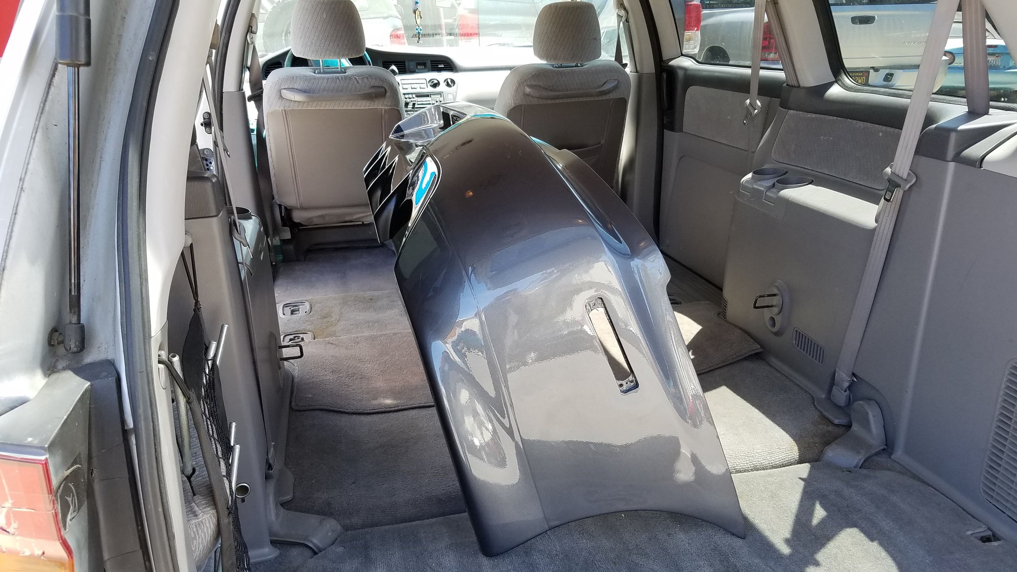

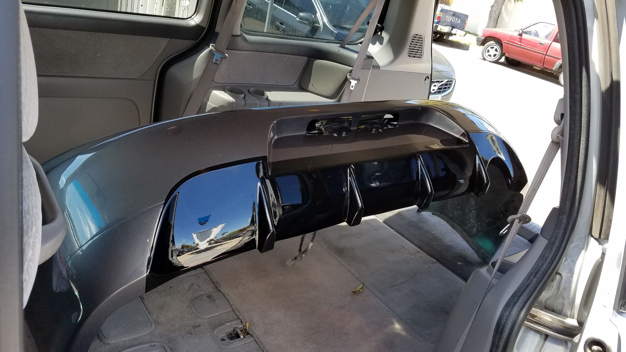

Just got the AIT bumper back from paint and I will be installing it tonight. I'll let you guys know how it goes. For now, here are two painted pictures off the car sitting in the back of my mini van.
As with the OP of this thread, all comments welcome.

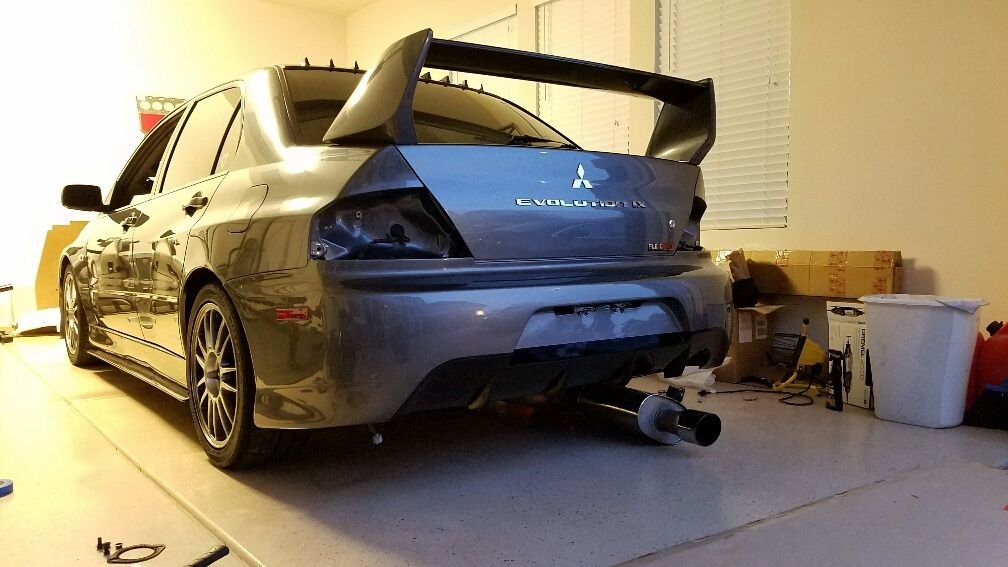

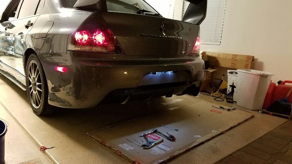

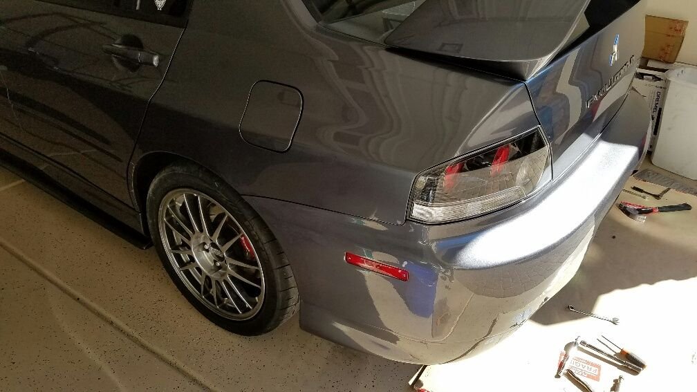

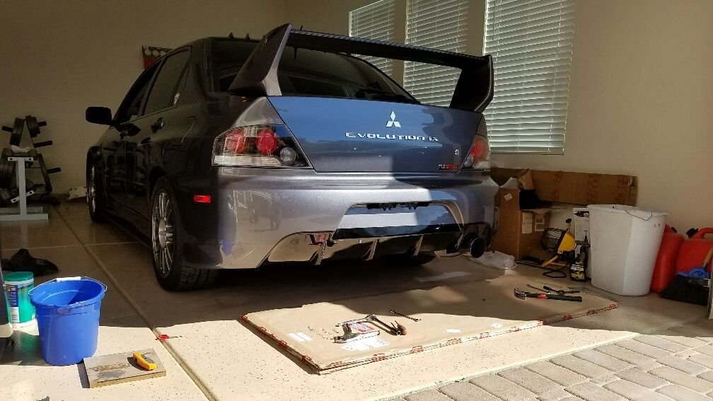

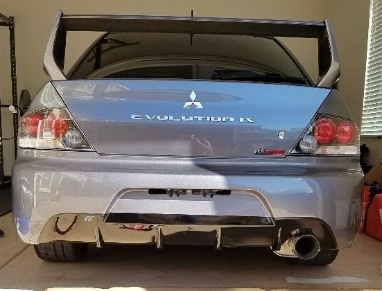

Judgment day.
Who likes it, who hates it?
The quarter panel gaping isn't as good as OEM but it's pretty close. Everything else looks solid!
I also have to mention that I was rear ended a few years back and both my quarter panels had to be replaced.
Total Costs:
$280.00 for bumper + $250.00 for paint (Buddy discount) = $530.00 for a painted JDM bumper that fits over the stock crash beam and keeps the side markers.
Need to work on exhaust fitment next!
In conclusion, if you have the time and want to save some dime, commit the crime!
Thanks guys.

Old Apr 20, 2016 | 11:55 AM
  #68
escodotcarter's Avatar
iTrader: (16)
Posts: 911
From: NY
not sure if it was mentioned before but JDM rears don't have the side markers like the bumper in the ^^^ photos does. that's a dead giveaway.
Yes, one of the reasons I listed in my earlier posts on why I didn't buy an authentic JDM rear is because I didn't like that it eliminated the side markers. I really wanted to keep them. AIT also makes a replica JDM rear without the side markers, but I chose this one on purpose.
in that case, everything looks good. fitment seems spot on.

8 hours is a lot of time.... for me i could work those 8 hours and buy a new jdm bumper with money to spare and know it fits perfect
Old Apr 21, 2016 | 10:05 AM
  #73
Pal215's Avatar
Joined: Apr 2008
Posts: 2,925
Likes: 361
From: San Diego, CA
Not everybody makes $100.00/ hour my friend
I used to study more than 30 hours for final exams back in university. I thought if i'm willing to do that, the least I could do is allocate a portion of that length of time to something I enjoy doing.
-pal215
