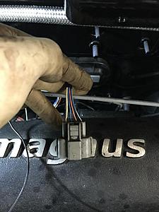

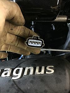

Hey guys im currently finishing up my wire tuck on my evo 8 (which i plan on doing a little write up and showing how it went later on). It seems i have 1 plug left thats been puzzling me. i cant seem to find the other end it connects to, and its the only thing that i seem to have forgotten to label, seems like i may have over looked this one plug. anyways, before i go any further i really just want to solve this and figure out its destination, ive even looked at another friend's evo and could not find anything like it... any help would be great. the car has a built motor, stand alone, and some sensors and plugs are not being used anymore. im just not sure if this is the case with this plug also. thank in advance

Alternator or one of the two coil connectors. I'm reading this before bed so I'm just guessing. I've done a wire tuck and know the feeling. I'll check back to see if you found it.

im know its not the coils, the coils are 3 pin plug. ill check the alternator, now that i think about it idk if i already fed that wire through. ill check and let you know. thanks so far!

a few days late, but it was the alternator, thanks for the help.
