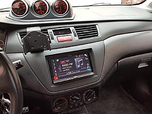

Originally Posted by cdrinkh2o
I used this kit for my Pioneer AVIC 8200NEX. Quality of the brackets and surround is good and it fits perfectly.
I have this same setup. Works great
Kinda off topic but what gauge pod is that?
that's the rexpeed gauge pod
Awesome, thanks.
