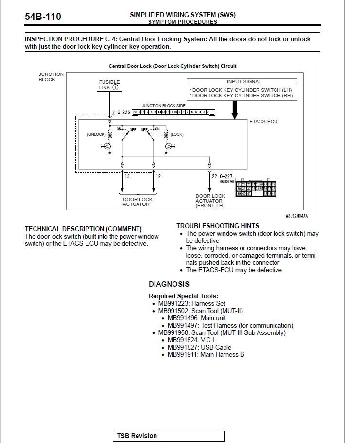

Yah that might point to a problem with your Etacs
Old Jun 20, 2017 | 08:28 PM
Biggiesacks's Avatar
Posts: 5,690
Likes: 708
From: West Coast
could also be the driver door window/lock switch box
