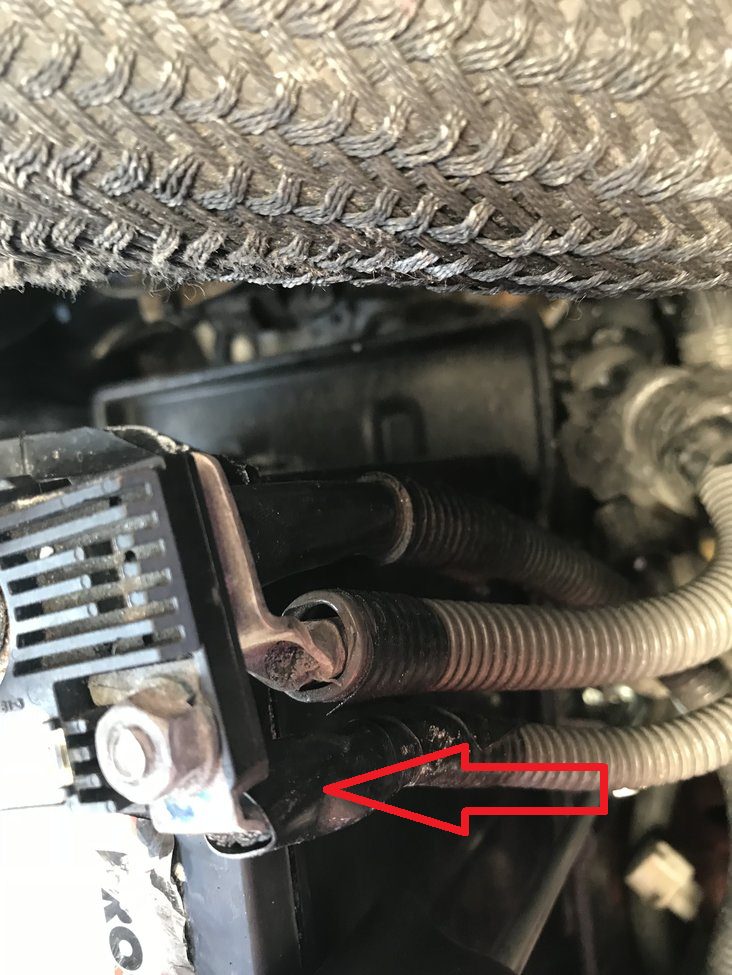

This is the backside of the positive terminal, does anyone know which of the of these is the power wire coming from the alternator??
I’ve made a post regarding the issue I’m having with a 160amp alternator at high rpm.
-belt isn’t skipping
-everything works fine if I stay under 6k rpms
-anything after 7k rpm I get a battery and brake light on dash meaning it’s not charging the battery but it’s not constant, it’s sporadic and happens whenever it wants
-car has left me stranded twice and starts right up with a jump
-stock 100 amp fusible link is good
-had both alternator and battery tested and all checked out good
I’m still running the stock power wire from alternator to battery, I’m going with one of these two options
1. Add a 4 gauge wire parallel (meaning I’ll leave the stock one in place) with an inline fuse, but I’m just not sure if this method is ok to add a second fuse.
Or
2. Eliminate the oem power wire all together and use a 4 gauge with an inline 180-200 amp fuse since it’s best for the fuse to be 20% of the alternators amperage. My issue with this option is I’m unsure of which of the wires in the pic is the power wire. I don’t want to cut and open the harness for just one wire.

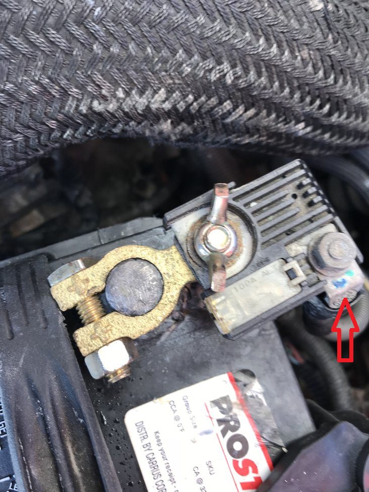

Marked the alternator wire but I think something's wrong with the regulator for your alternator than the wires.
If you want to upgrade wires, do the big 3 upgrade,not just the alternator wire
Thank you very much man!! I’ve been searching everywhere
