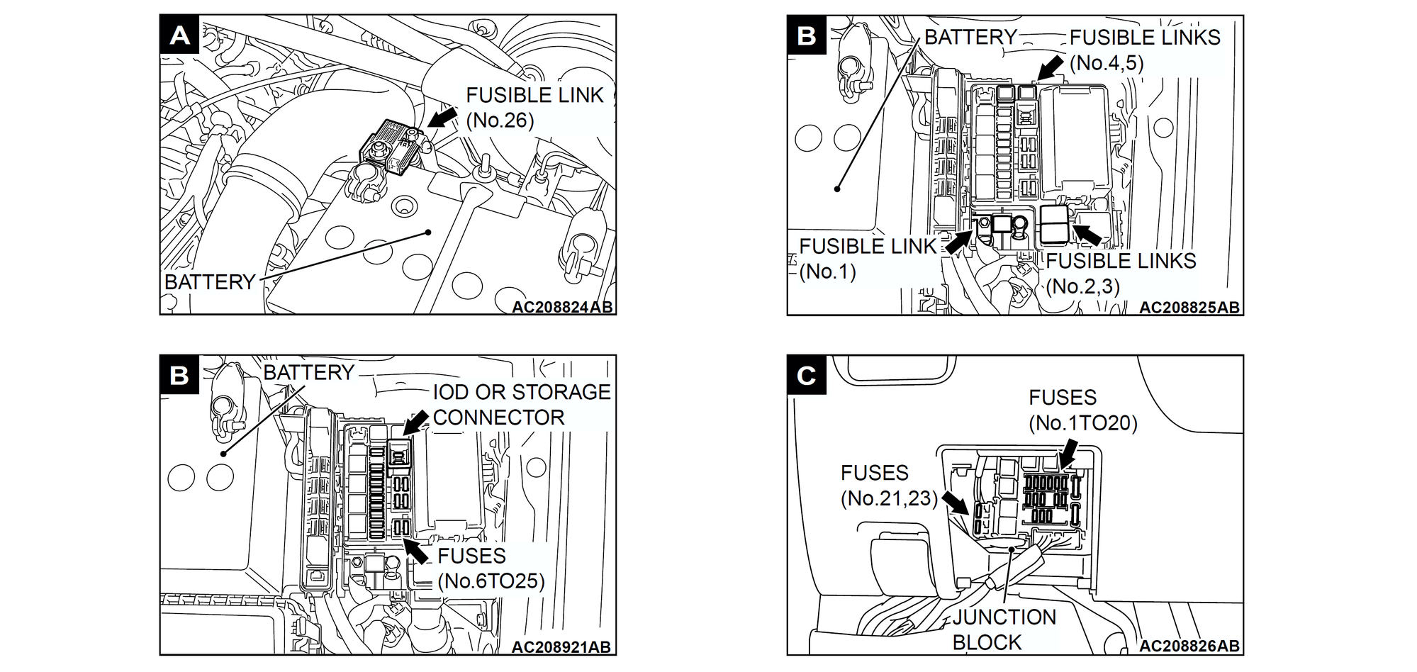

pop the cover on the bigger fuse block under the hood and check the bolted in fuse at the bottom. Use a Digital Multi-meter in beep/continuity mode on both sides of the fuse to verify it is intact. Fuses can look visually fine but can be blown.

many of the fuses could have blown. You will have to work your way through the different circuits if you find something isn't working. Since nothing is working I pointed you at the main fuse for everything to start with.

Fusible Link No.1 is the main fuse for everything.

I tested fuse link 1 and seems to be good along with all other fuse.
