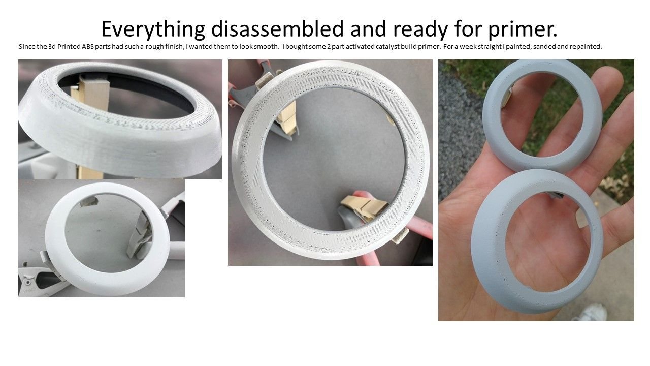

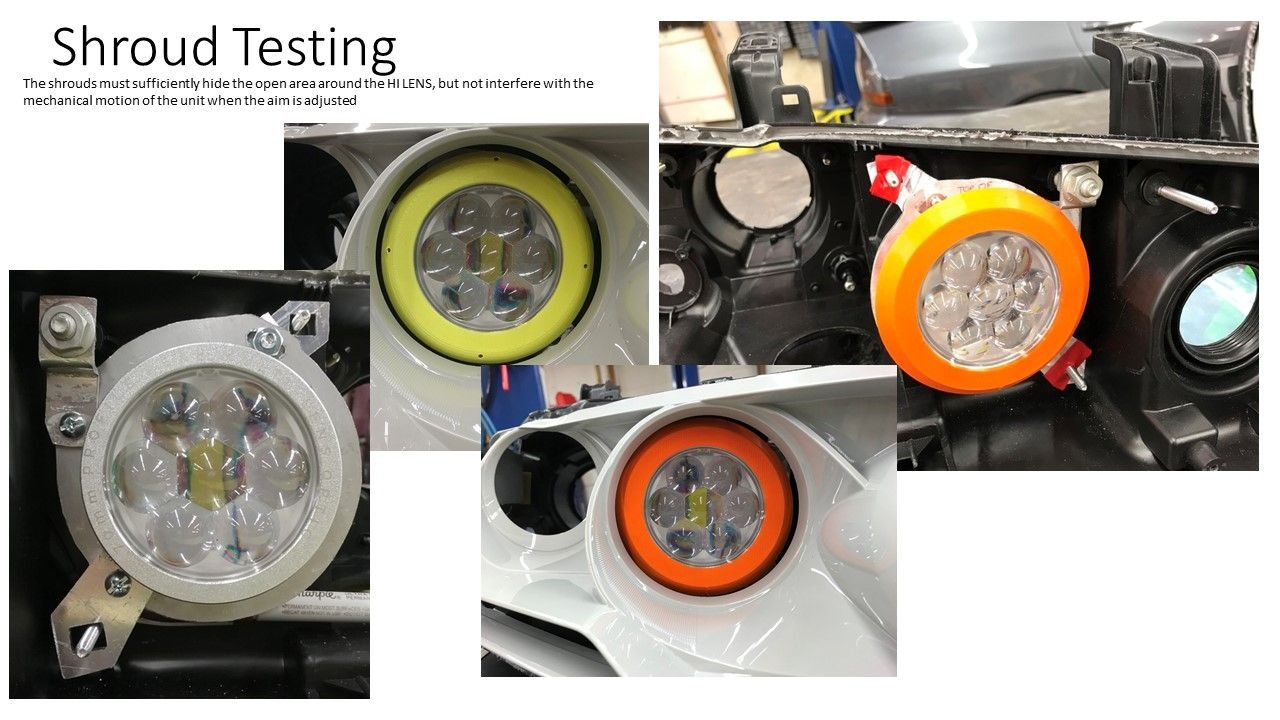

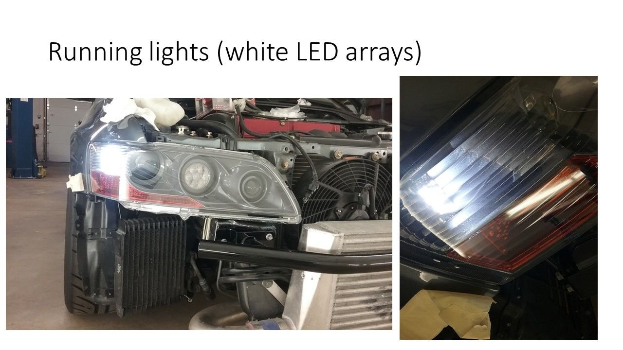

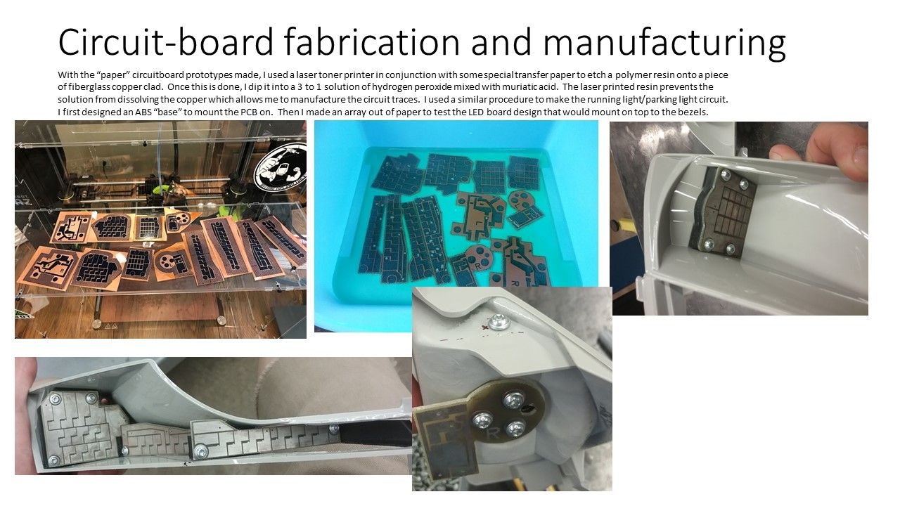

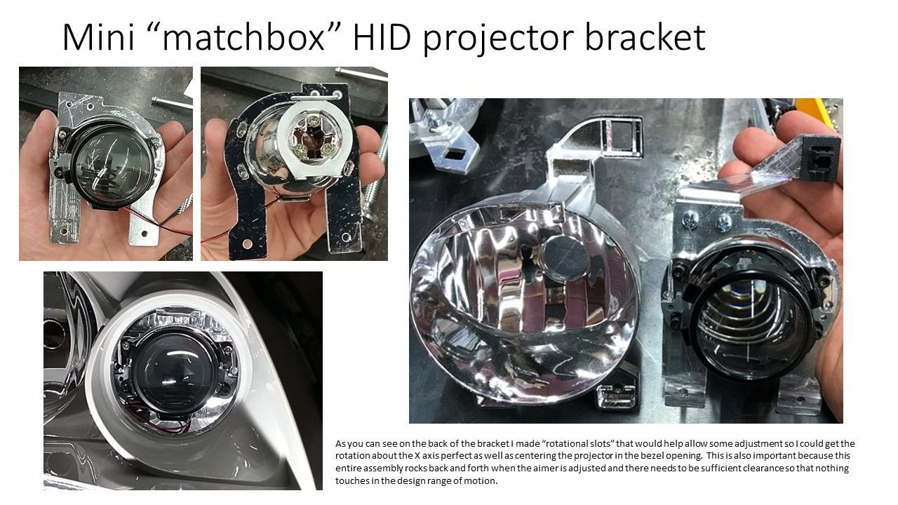

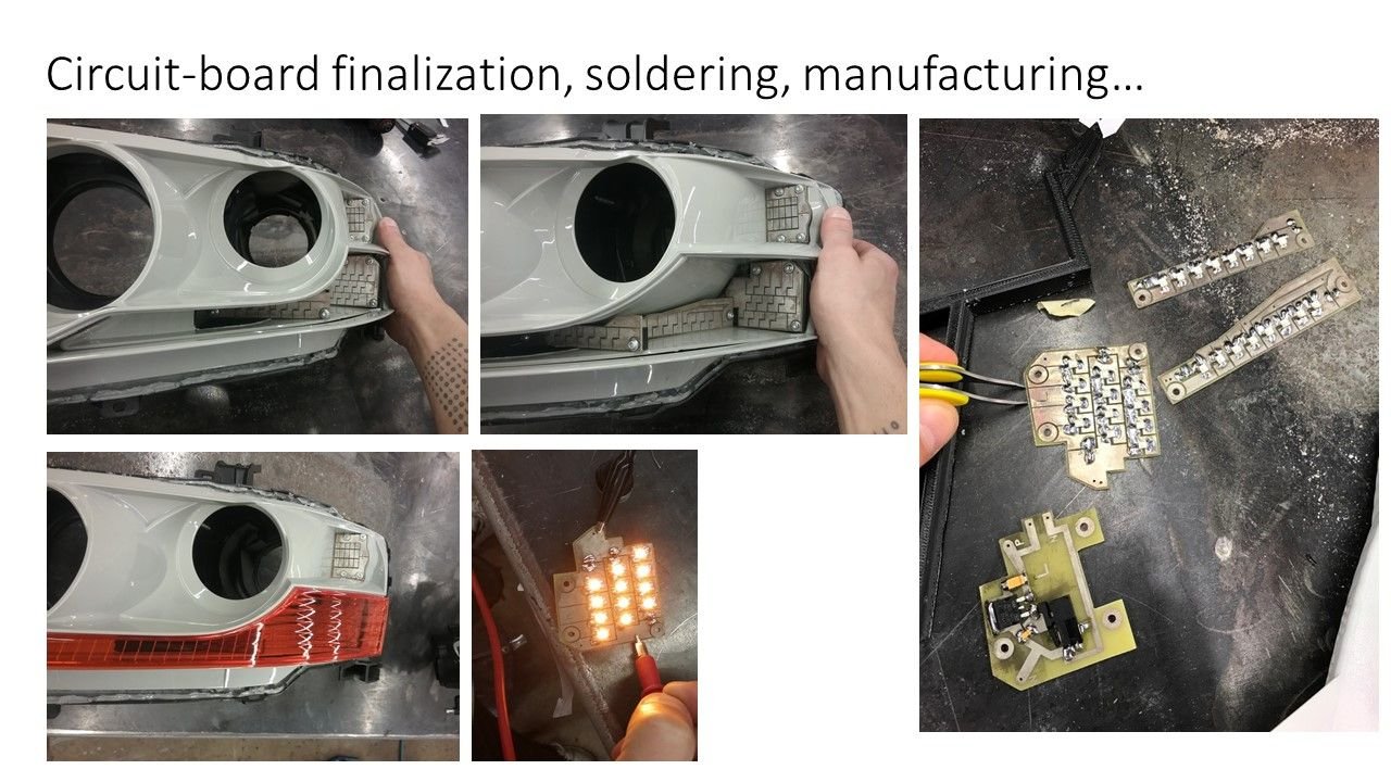

Here are slides that document the headlight build I just completed for my Evo IX. I humbly apologize if the pictures are large, however I put them in a powerpoint and made jpegs from it.
I hope you enjoy.
