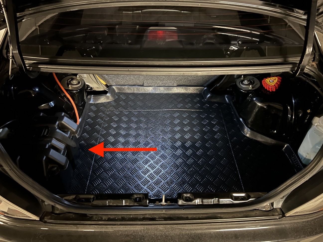

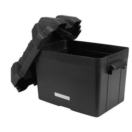

By the way guys.. why dont you just move battery to the trunk? It gives you lot of free space in engine compartment, also it's better to pull this weight to the rear
I didn't bought any "kit" for that purpose. Just good thick cables. And I bough my battery container in fishing shop for 20$ lol . It came out they use similar batteries in boats.
I fit in there 70 Ah / 680A EFB battery (size 260x174x255 mm). Works perfectly!

I was about to move my battery to the back... until I got the cable. that thing is heavy so I returned it. a full size battery is also heavier.
Well if the weight is an issue then yes. But I prefer extra kilos if I park outside and here in winter we have like -25 C. I never had a problem with starting it. Those EFB, AGM batteries are worth checking if you want a reliable car in winter.
