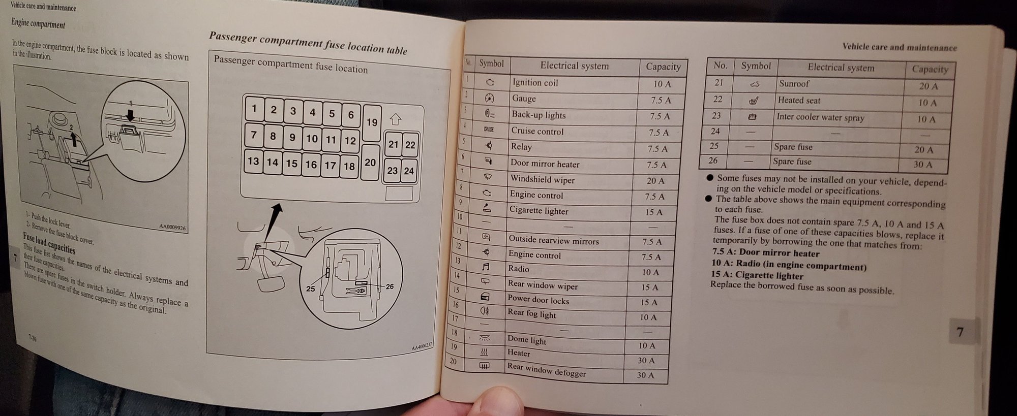

Old Feb 26, 2024 | 07:50 AM
MionieEvo's Avatar
Joined: Sep 2007
Posts: 50
From: Millville, NJ
Fuse layout in owners manual
I see nothing about keyless entry.
i didn't drop or damage the oem remote. I have no idea what to do at this point. I don't see any blown fuses. 😑
