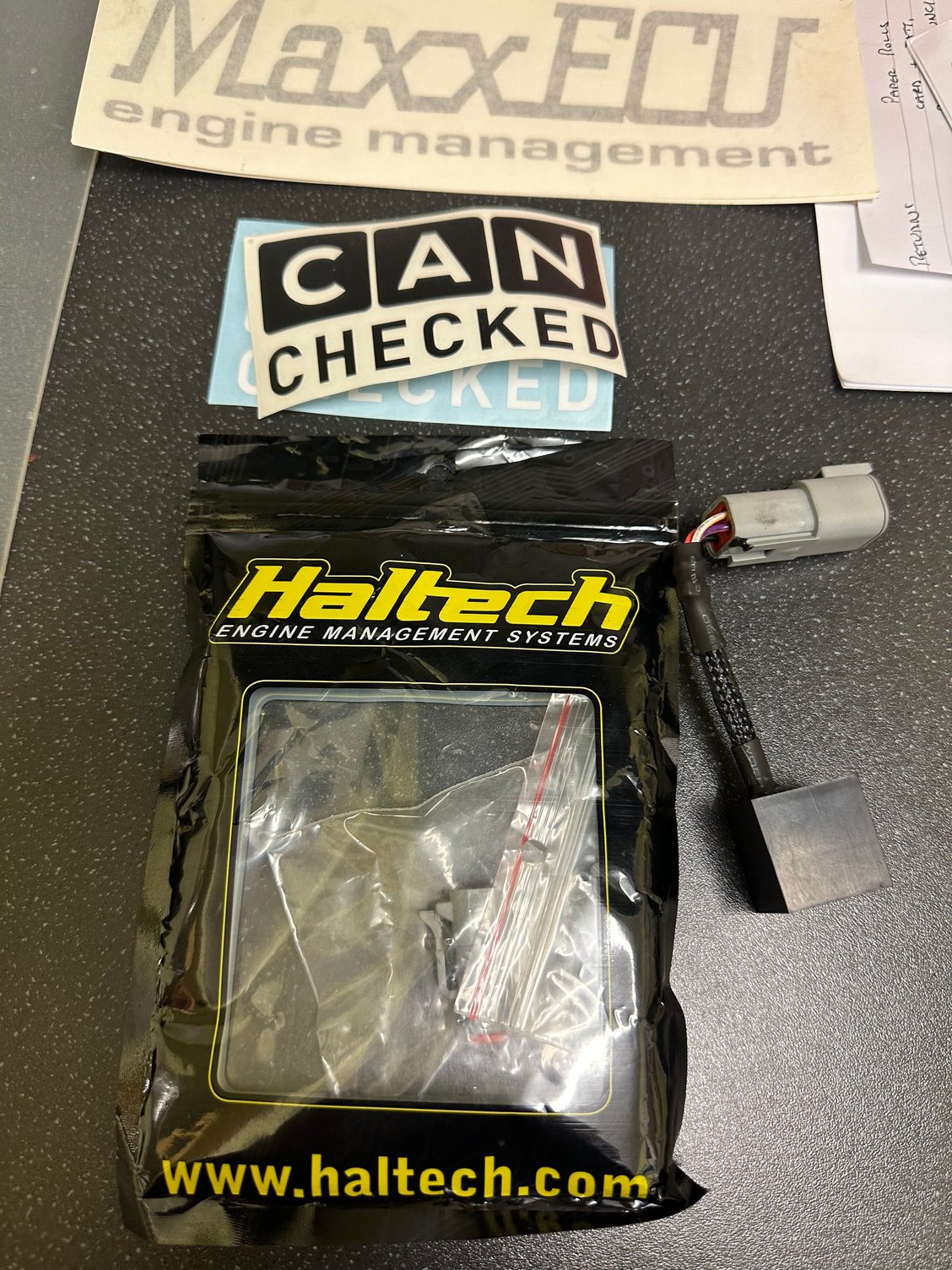

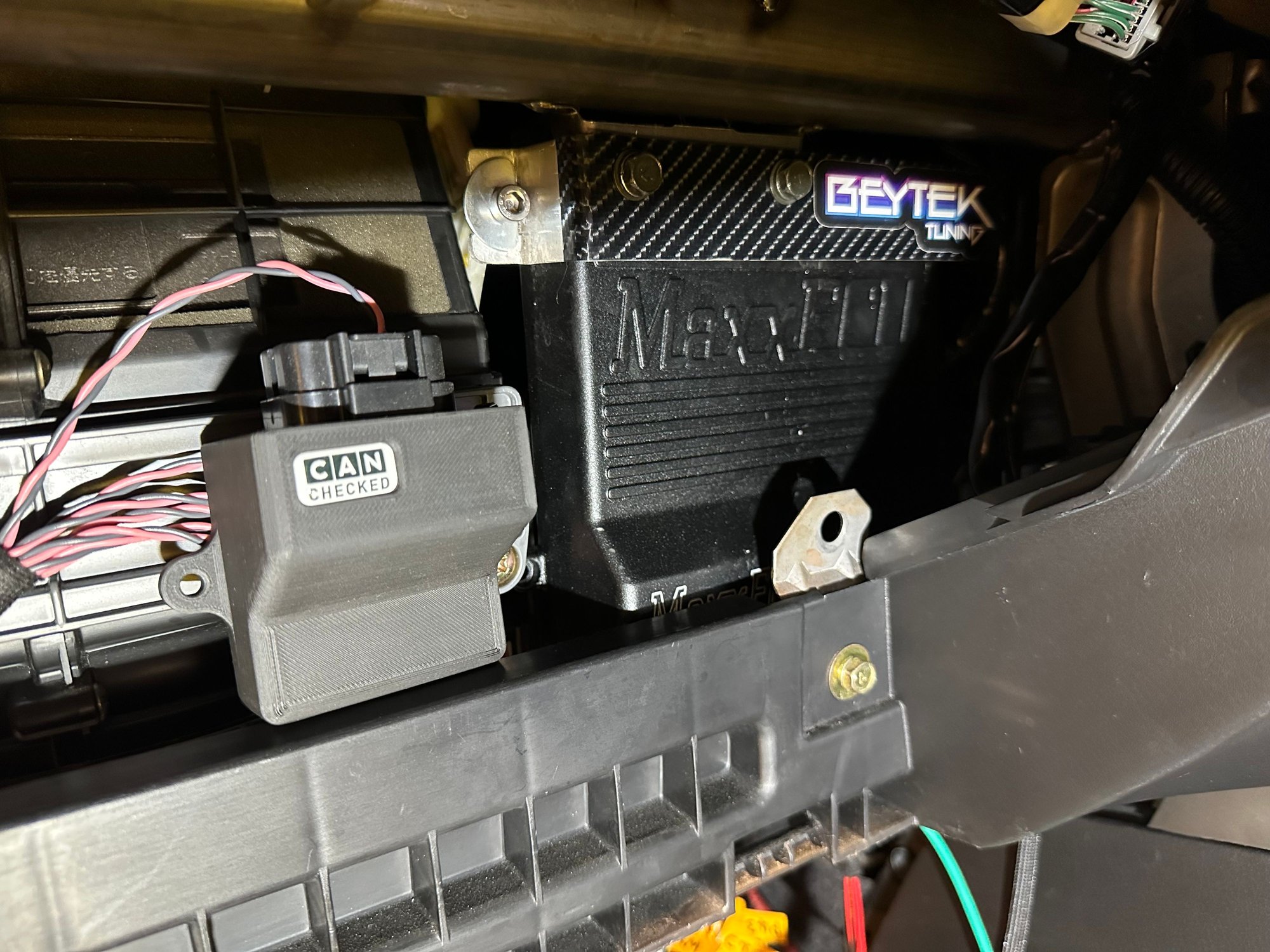

Hi, I have literally just finished a Maxxecu conversion on My Evo 8. I use Maxxecu Race, originally bought the plug n play kit but was a 4 plug and my car is 3 plug so had to rewire from scratch which was very easy. I am using E throttle and E pedal plus some other upgrades.

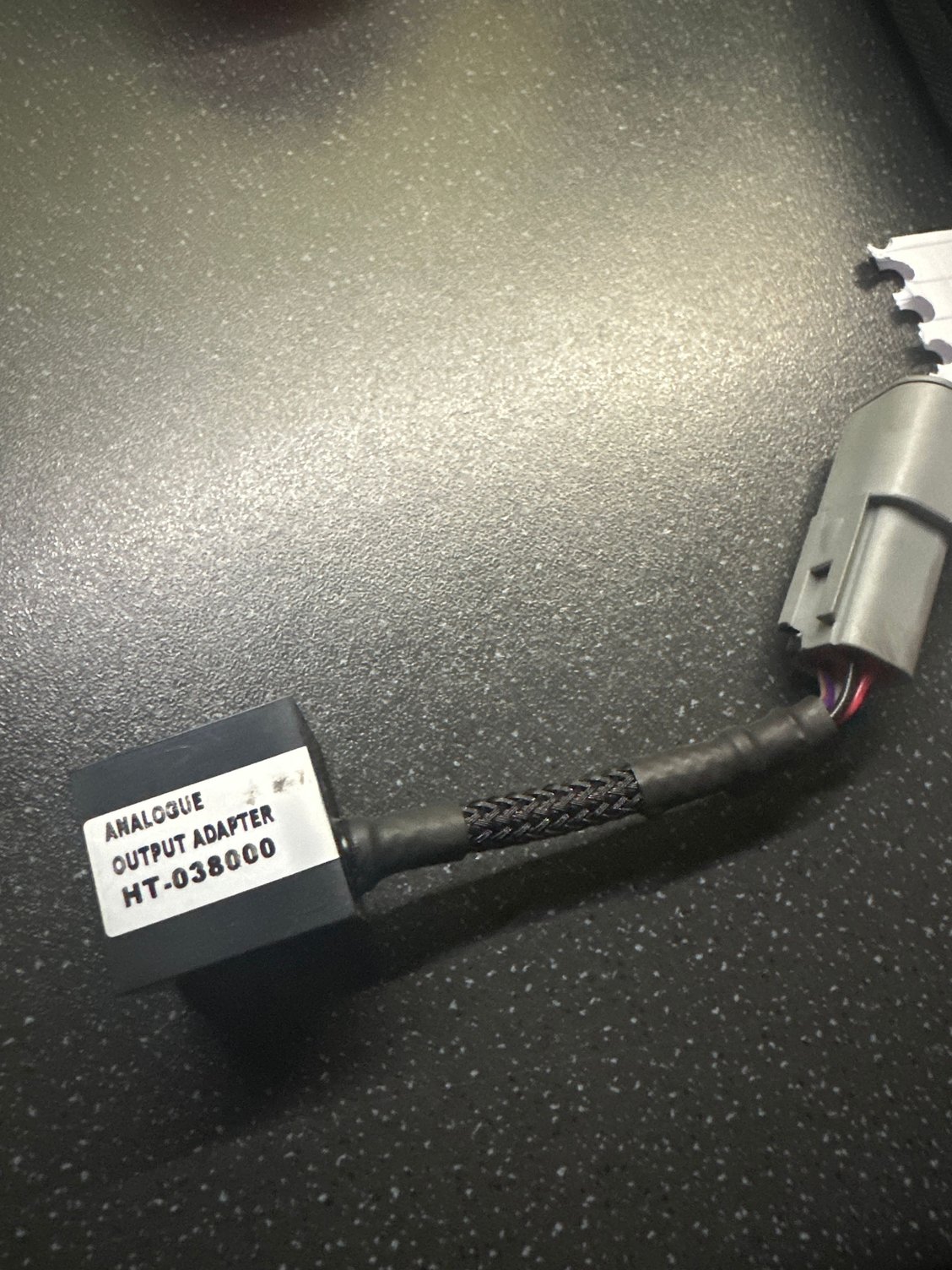

with maxxecu there isn’t a dedicated 0-5v analog output so we have to get creative, you need a PWM to 5v output to feed throttle position into the AYC controller….
I used a Haltech analog to 5volt converter and used spare ignition 5 output, the table in the ecu is basically just seeing one of the 5v from the E throttle body and converts PW into 0-5v to mimic the TPS
very simple and works fine, if you are smart you can make a converter for the price of a coffee! I bought the Haltech thing for ease
Maxxecu Race with canchecked input expander
