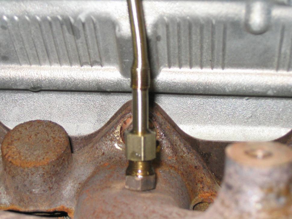

this is my omori probe installed but it should look about the same
