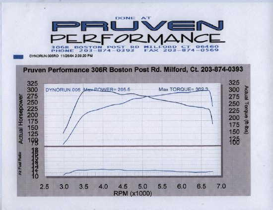

I think that you can best grasp a concept often when it is visualised so I want to offer a few concrete examples of how lean a/f ratios effect tuning and how I can smoothen up the power band and make the car run better with a slightly richer a/f than others may recomend
Here is a typical Evo with an aftermarket intake and a stock ecu which distorts the MAF sesnor reading and results in an overly lean a/f through the meat of the tq curve. Of course this will result in some knock and the very senstitive stock ecu pulling ignition timing
making the car a tad richer makes it smoother but you can see how the slight lean spot really causes knock and timing pulling even one one dyno pass. Aftera few more the timing would be all over the place.
You can see after a properly rich 11.1 a/f ratio the car becomes much smoother and has a much better powerband

Another example of a very smooth and refined power band at a 11.1 a/f ratio

Stock 2005 RS with Dyno Flash and 11.1 a/f

Of course - what do I know about reflashing anyway? Here is the USAs' most powerful Evo 8 on a reflash - member Superz who runs the AMS GT35R kit on a bone stock Evo 8 block and head. He runs this car every day BTW with no isssues
Rich = powerful and safe
Thats right 523 whp

In this case nearly stock evo is making more power running richer
