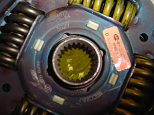

I just recieved my kit today. the MB7-HDSS, but one question....my disk package was opened, but in the unopened ACT box. The disk is an exedy disk model engraved says (MBD088U), the kit says the disk should be a MBSD088S....whats up with that??

That is the Exedy part number that we modify and place our linings on. The linings should have our logo on them (old logo) and it should be SFI certified, dated, etc. by us. Email a photo if it is not.

this is what I see....just didnt see your guys model number engraved anywhere...I see the date, etc, and the SFI sticker and local on the surface of the disk.
and the other is how the package was slitted open inside the kit box. its new and unused though...haha
