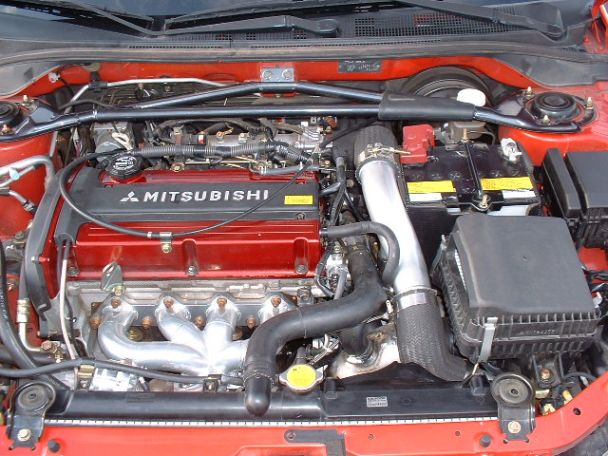

Finally, a picture.
No problems so far...

Old Apr 9, 2005 | 06:45 PM

what other mods are on your car?

Old Apr 9, 2005 | 07:22 PM
vletnguyen's Avatar
iTrader: (26)
Posts: 335
From: Clearwater,FL -or- Seneca Falls, NY
wow. it could pass as a stock engine bay.
just need a exhaust shield and most people couldnt tell
