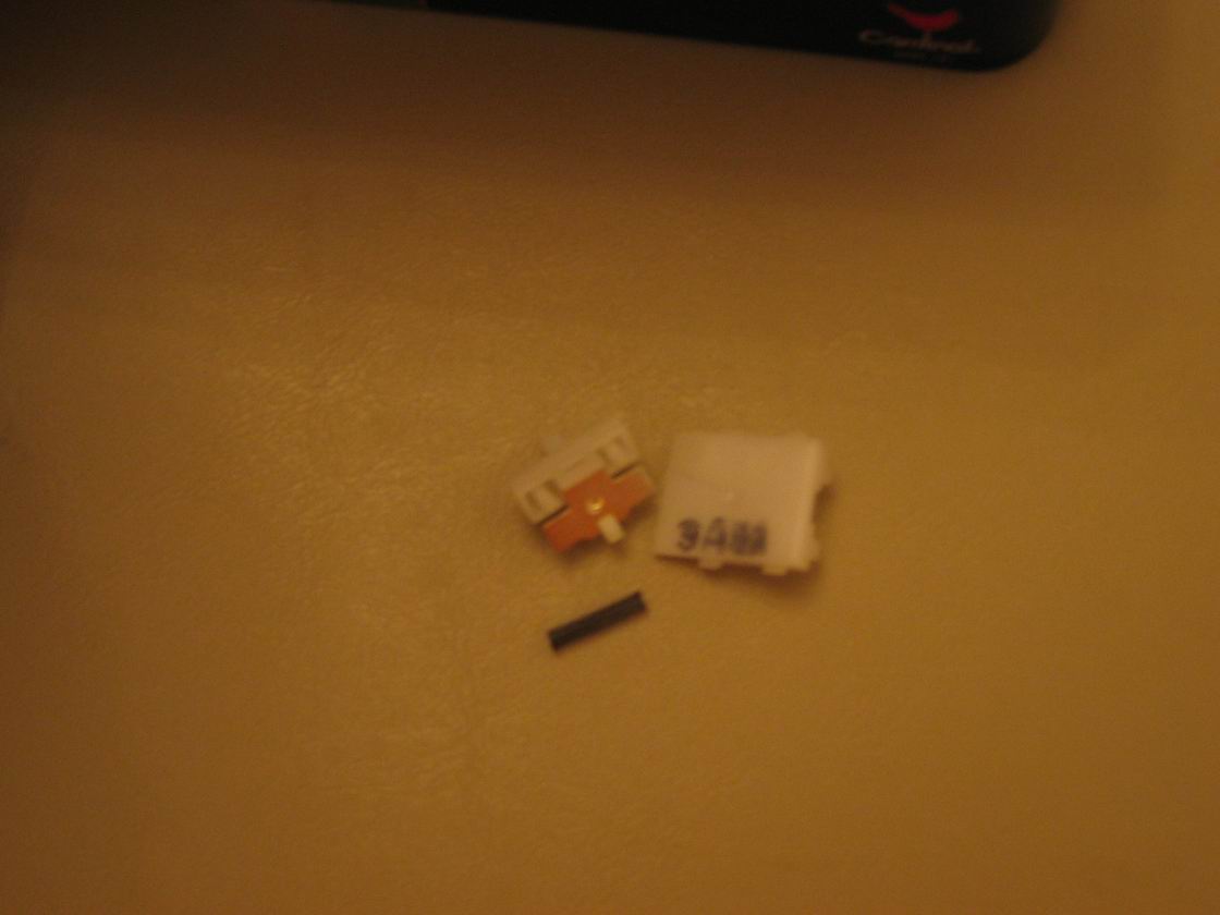

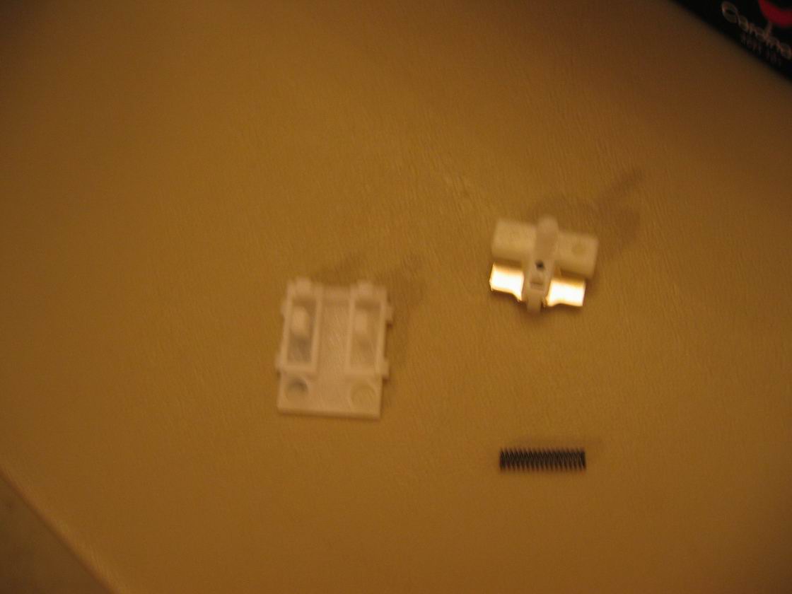

Just got down installing Apexi Turbo Timer using the harness. TT seems to be working fine but my stock keyless entry is not working. Car won't lock or unlock using the keyfob. ANyone experience this before?
Also when putting back the steering column three pieces feel off. Any suggestion as to where it came from? Now the car will chime when the key is out and the door open. It's as if the car thinks the key is still in when it's out.
I'm going to take it off tomorrow and see what went wrong. Any help or suggestion would be appreciated. Sorry picture is blurry.

It looks like the part is the key reminder switch. I tape it back up and everything is working fine now. If anyone have a wreck EVO that is selling parts like me know how much you want for it. If anyone how what the part # is that would be great. This is the white plastic switch that is bolted near the key cylinder switch. I only need the white housing piece.
Anyone who's putting a TT don't make a stupid mistake like me and remove or lossen the bottom plastic cover before removing the upper and lower column.
