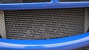

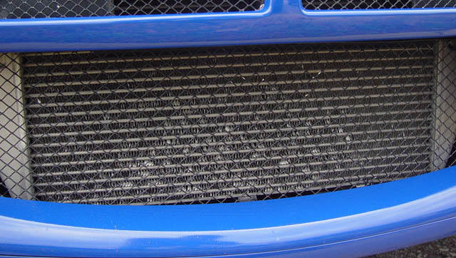

My intercooler took a hit from some unseen force, I looked at it carefully and didn't see anything other than a handfull of bent fins. I was going to try and straighten them out some.
When I put in the Defi, I saw that the boost recirc valve had it's bottom fitting loose. I tightened it, it's not the first time I have had a fitting come loose. I looked around at the other fittings, things seemed tight.
I have heard that the stock BOV is nearly silent, I can clearly hear it sans radio, some times over the radio. I don't have any other Evo's to test against. I have thought about going to the dealer to test drive one to compare against.
What should the stock vacuum reading be?
