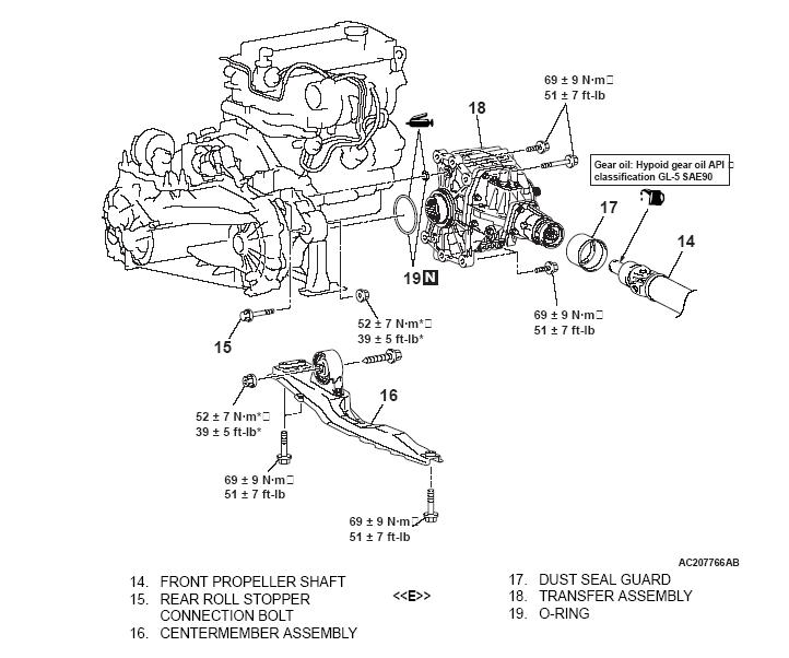

Are you talking about o-ring 19? The big one?
Old Jun 1, 2005 | 12:44 PM
instigator's Avatar
Posts: 512
Yes.
It isn't too bad to replace. Just pul the downpipe and the pasenger side axle and it should be able to come out after removing the 6 bolts holding the TC on. Then swing it to the side and replace the ring. Just lube it before putting it back in.

When I installed my quaife front LSD, I wondered what the hell that small o-ring was for. There's another o-ring of the same size downstream on the t-case cover. There's no passage on the cover, so maybe there's an oil passage on the housing somewhere. I forgot to look for one when I had mine apart.

Originally Posted by instigator
Yes.
Not exactly that easy there is a shaft that you have to pull out. It can be a REAL B!TCH!!!
