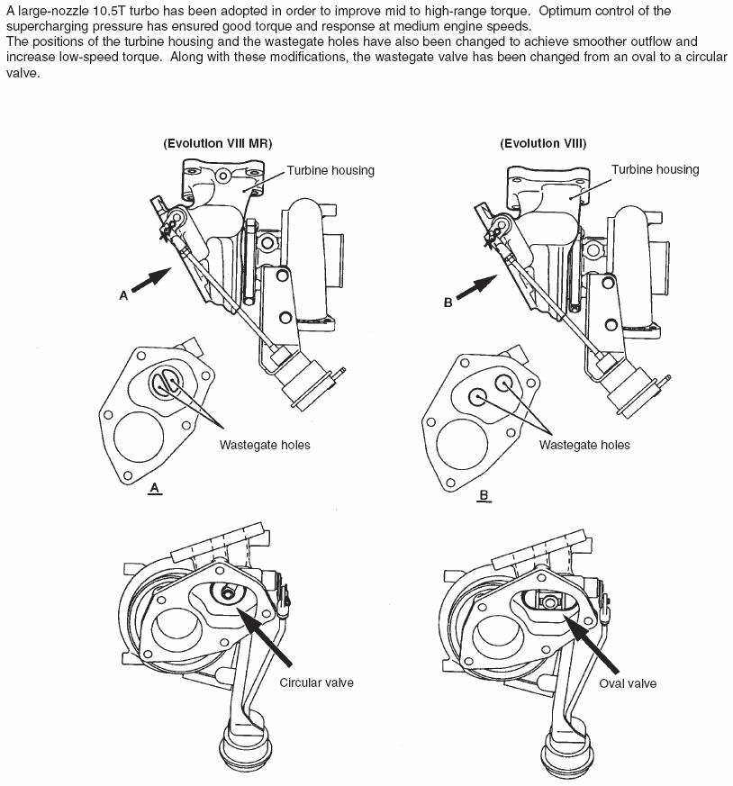

Here you go. Got this from Jamie's NorCalEVO gallery.
From the description, it sounds like the 05 style wastegate helps low end better. I'm guessing that the new wastegate design enables the exhaust path to the turbine wheel to be shaped for better flow.

Does this mean the wastegate valve needs to be change as well??
Old Jul 12, 2005 | 08:15 PM
marksae's Avatar
Posts: 2,995
From: SF, CA
Nope. The wastegate valve comes w/ the hotside. They are not interchangable either since the path up to the valve will be shaped differently.

hi,nice pics,so which one is the 10.5 hotside A or B?
