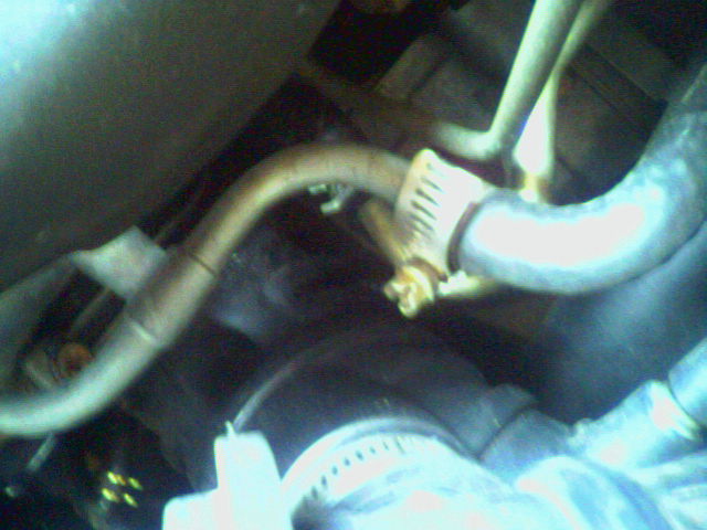

Hey Doug at Top Speed..i am the tread poster...i could be at topspeed in 2-3hrs. Do you think you guys could solve the problem?? I just talked to your sales and he said you have 1 Forge MBC in stock. I cant take this 11 psi anymore! What do you think?
Old Oct 27, 2005 | 07:59 AM
  #44
steevo's Avatar
Joined: Jul 2005
Posts: 572
From: South
Best pics i could get...sorry ..cell phone cam. I hope this could possibly determine whether or not i have the hoses with the pill restrictors.

Originally Posted by Karash
Sounds like your vacuum hoses on your BC are backwards.
that's what I was thinking too. If the lines are roughted wrong, it just uses the wastgate to control boost. 11-12psi
